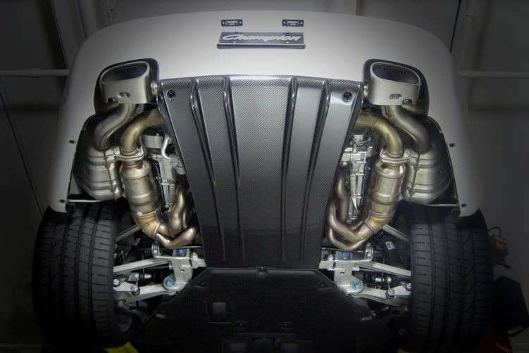

Is there any benefit to having a splitter behind the rear wheels of the car as far as aerodynamics?
The lowest vent piece is just there for show as its not attached to the IC ducting. Since having a splitter between the tailpipes seems to be no-go as far as fitment, I wanted to see if this would be any benefit at all.

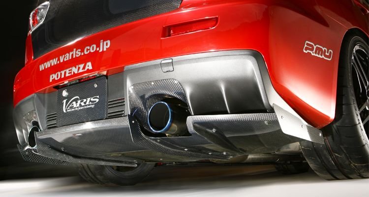

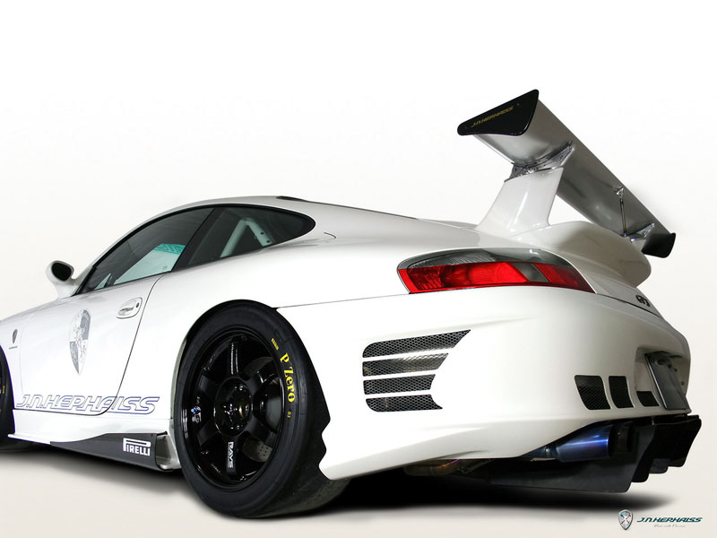

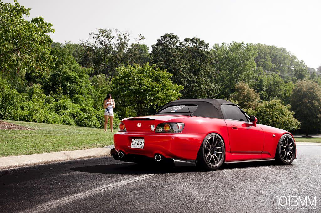

I can say all those examples above are cosmetic for the simple reason they are no where near close enough to the ground to create any significant ground effects

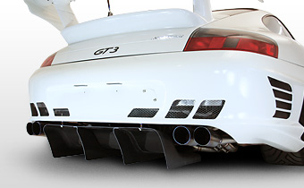

A properly designed rear defuser is one of the best downforce vs drag you can do. Why it's usually a very regulated piece by most racing organizations, But most of these as pointed out are not. Check out some pics of Tudor GTLM cars or the FIA Gt3 spec cars in World Challenge. Hard to do on our cars, I don't know of any off the shelf options.

Exactly right. All of those are just for looks except maybe the red car that you can see under. The side piece you are describing should be part of a completely flat bottom and the diffuser coming out. The side vents you are describing allows air to pass though the intercooler and out. If you block it then you would pack air in there and will experience higher AITs. our cars already have a pretty well designed flat bottom, but all goes to hell at the motor.
