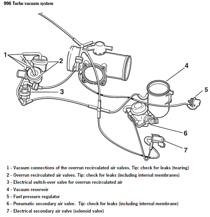

Neither 3, 5 or 7 is the n75 (boost solenoid)......,,,

**** I'm looking at recirculation valves mot the gates my bad there
