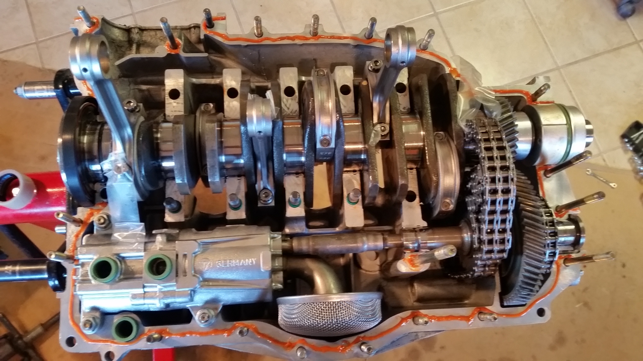

Done with the lower crank case. I think I really did a good job. The crank spins smoothly. I fumbled around with the first two stretch bolt seals but once I got the hang of it I was able to blow through it pretty quickly. I have to resituate it on my cheap stand so it is on the ground for now. Feeling good!

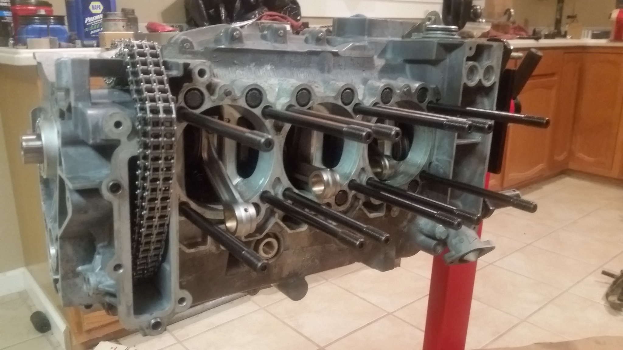

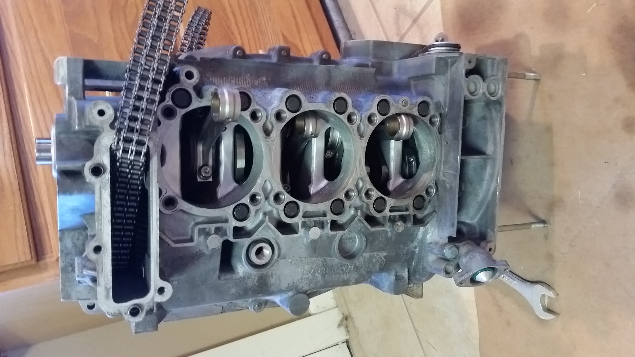

The answer to the problem is brute force provided by 12mm studs. Sean really did a great job on these. The holes are all drilled on his CNC and Sean is using Time Sert inserts now. I might have the best P car stud job out there.

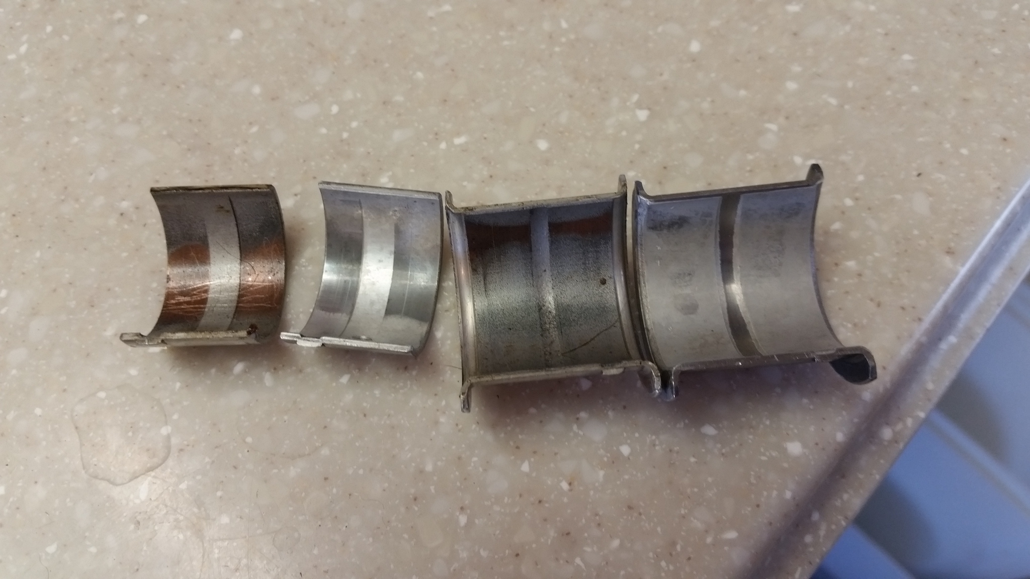

Public service announcement! Here are my old bearing shells for the intermediate shaft. As you can see they have quite a bit of wear on them. The IMS is last in line in the oil gallery system. This is why it is important to run your engine above 3000 rpm. You need to keep your oil pressure up to keep your parts floating over the bearings or they will wear and cause more IMS noise at idle. The previous owner of my car is from San Jose and likely spent a lot of time in traffic lugging the motor.
