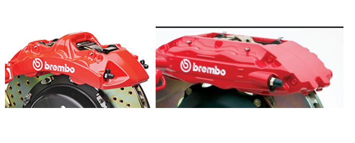

Some calipers have a bridge in the middle. It provides increased stiffness for the same or less weight. Stiffness = better feel in the pedal. Something to think about.
