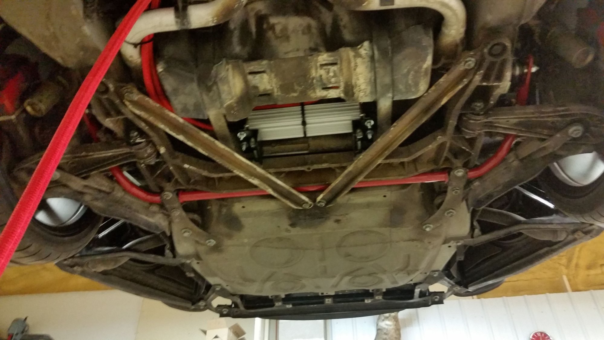

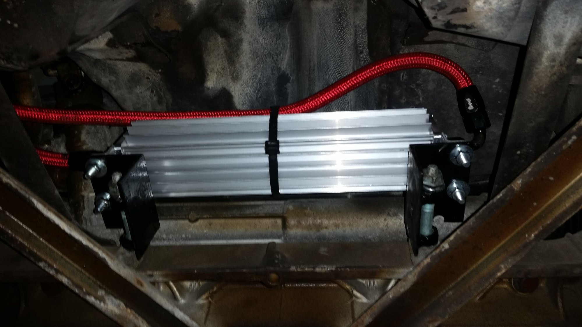

I don't run the oem fuel cooler but do run an air cooler up front where my front diff was.
