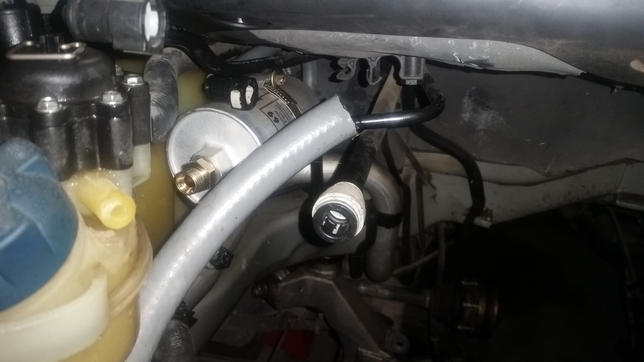

The durametric worked. Thanks for the help. My pump runs continuously and fuel comes out of the line as pictured.
