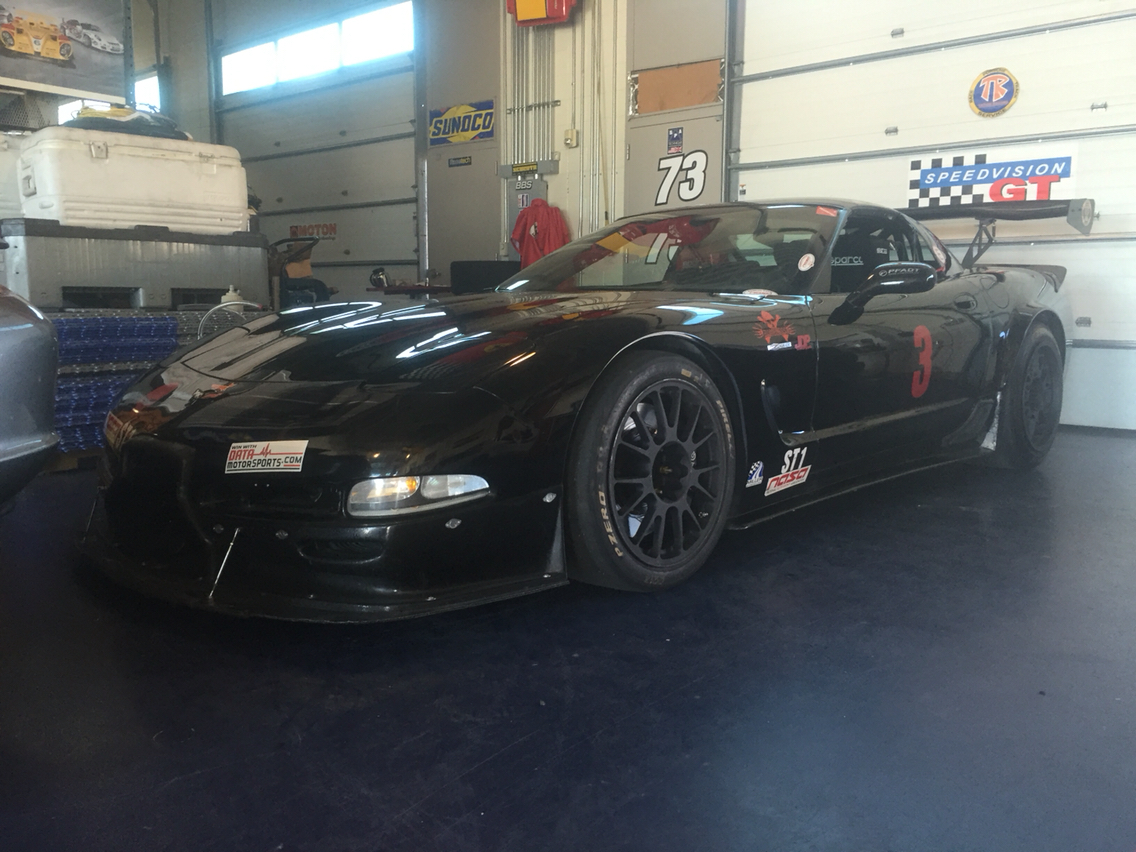

Maybe hang in with what you have till you decide what direction you want to go at the track, wanting to race? Do time trials? Want to be in a field of really competitive cars to battle with? Maybe you just want to improve your own driving and car for track days. Figure that out and buy the car already done. Like 32crazy says if modding and driving your turbo is your passion that's what you should do! An LS fd would be cool. Building race cars gets expensive I'm in my NASA ST1 car over 80k not including the car should have never added it up

Yeah, I definitely want to go towards a track car. I just dont drive the TT enough as it sits as I am not much of a 'cruiser'. I spent almost all weekend going through the build for the RX-7 to make sure what the difference would be for the build. With the 33k it would have everything from Ohlins to a fire system and an Accusump.

Im just going to take some time over the winter and decide. The RX-7 and the 911 are the best cars Ive owned so it really is a toss up. The market might end up making my decision for me if they bump up again in the spring.
That is a beautiful C5 btw
