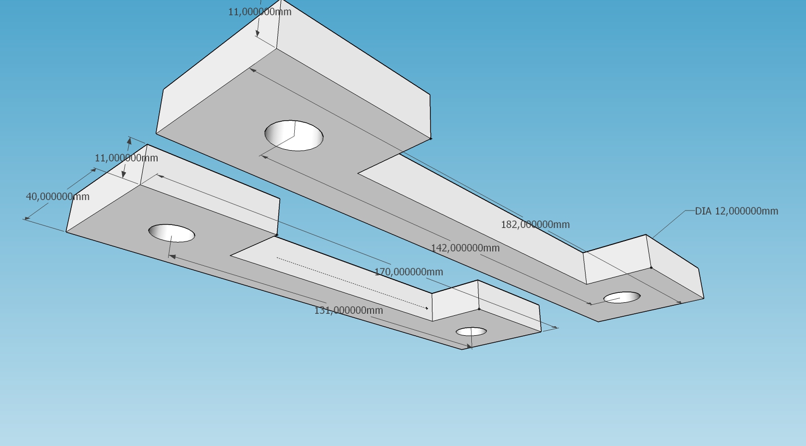

It's just to save weight. It is such a small amount I didn't care. I literally bought bar stock, cut to length, drilled 8 holes and bolted them up. Total cost with buying bolts locally.......26 dollars (us money) and 2 hours of time to make them and bolt all 4 sides up.

There really is no reason for not buying aluminium bars, cut and drill them yourself.
But i buy the bar from the same guy that has the cnc equipment, so then i don't have to bother with cutting and screwing things up myself.
Freddy, would you mind having a look at the photo and see if you agree with the dimensions?

Looks good. I'd drill the holes though 1/2 inch instead of 12mm. It gives you a bit of wiggle room and easier to install and remove.

Also i read though some other forum stuff and the official rear center to center is 130mm even know it measures 131 on all 4 rear calipers I have here.

As soon as i have the drawings 100% i will share them here, then everyone can just email it to their local machine shop.
Any update to the drawing?

The winters are long here in norway so we have all the time in the world to complete this =) expect 4-6weeks before its complete.
Im currently awaiting my new 350mm discs so i can testfit the printed plastic adapters.
Then i need to adjust them and print the modified adapters and if they fit the drawings are ready.
So stay tuned.

Another super simple way to do the spacers is to make them out of round 6061 stock which is much cheaper and a bit lighter. There is no advantage per se to have the spacer "bridged" since you only need a spacer under the caliper lugs themselves. 8 identical spacers will take car of all 4 calipers.
28mm OD x 13mm ID x 12mm thick is the 330 to 350mm rotor spacer.
