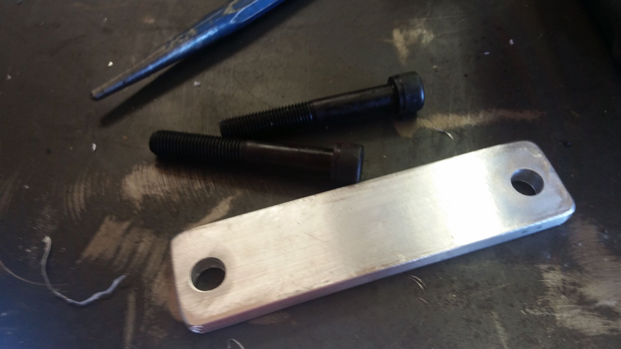

Hi
Does anyone have the measurements on the calipers by hand?
I need the size of the bolt holes and distance between them.
Im supposed to draw the adapters and have them cnc machined.
Are the adapters the same on the front as on the rear?

THE spacers to use 997/350mm rotors should be 11mm and factory 997 caliper bolts work for this set up. I don't know the other measurements but it may be easier just to purchase the spacers and bolts they are available fairly cheap .

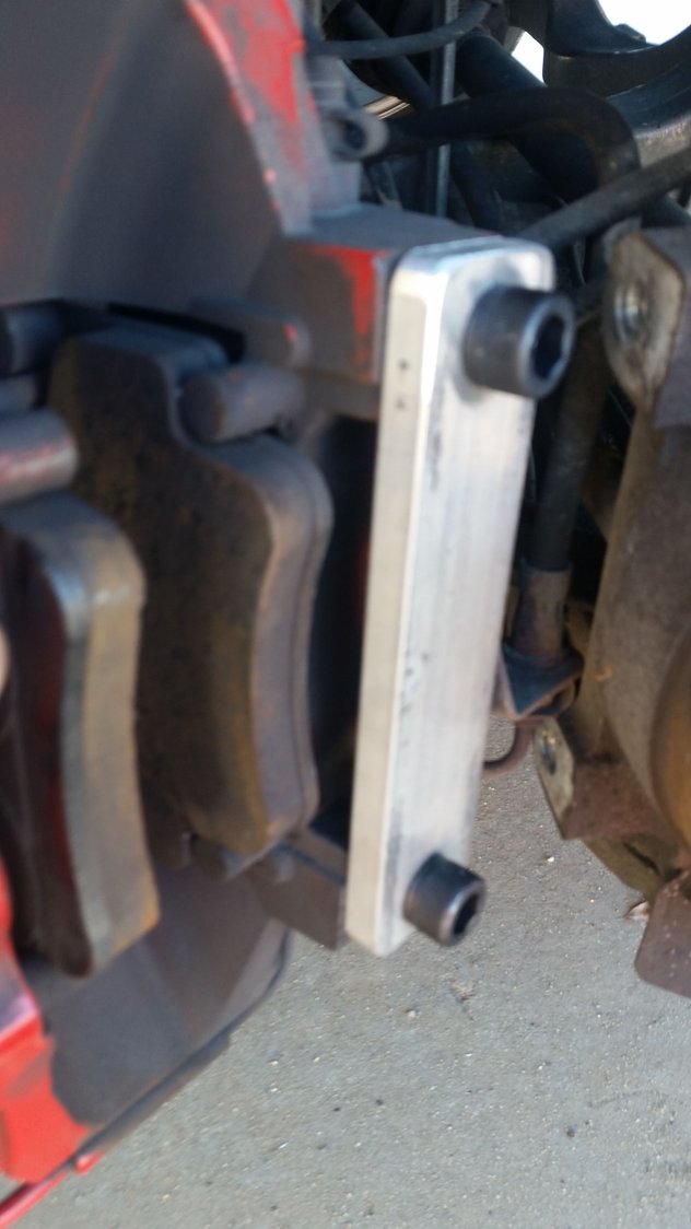

I use 11 mm. 10mm is working but the distance between the caliper and the rotar is really tight. with 11mm its better of course. But the downside is - dont know anymore if it was at the front or rear - the pads are sitting a tiny little higher than the rotor.

Very very slightly from my experiences you have to bevel the top of the pad and everything "breaks" in and wears together perfect. One time I did not and the front made crazy noise.

Yeah stock 996tt calipers w/ 11mm spacers and the 350mm rotors some pads have a very small amount of pad over lap. ATE's seemed to fit well, textars seemed to over lap a little more.

Front center to center is 142mm, rear is 131mm. You'll want to make the spacers 35mm or 40mm wide, 11mm thick. Bolts are m12x1.5. I use 80mm bolts but the 997 stock bolts are 82mm. 80 has plenty of thread in the hole though
