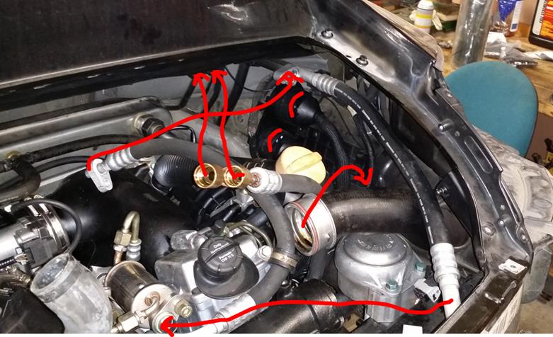

Need some advice.
I am completing the final steps to drop my motor. I have removed the air conditioning compressor from the motor and have it hanging with hoses attached.
I am now looking at the PS pump. I have disconnect it from the motor and can see how it can remain with the car without disconnecting the two large lines but it is attached to a coolant line (easy) and two small lines routed through the top of motor. It appears these small lines need to be disconnected. Not sure how to remove the lines from the pump (special tool) and am concerned about leaks. I've read remove to pumpfrom the motor and leave it n the bay but it appears to be more work and needs a special tool.
The other option appears to be to disconnect the large lines at brass fittings the top of the engine bay. Looks like this can be done by counter rotating two wrenches. The attached picture that I copied from the engine drop thread shows these lines disconnected and are hanging in the middle of the photo.
It looks like the easiest way to drop the motor is to disconnect these lines as shown in the picture. Is this correct ? Can I simply disconnect with two wrenches ? Do I need to worry about pressure or bleeding the pressure ?
Appreciate advice from those that have done this.

They are brass threaded fittings. Just need two wrenches. They look like quick disconnects but the are not. Be careful once disconnected as their are these star-like retaining pieces that hold the fitting together. Don't loose this as they can come loose.

Thanks, a little tight in there but simple. Should be able to drop the motor Saturday.

I dropped the motor several inches before disconnecting those lines. Easier to get to. Are you doing a slave conversion? If so, when the motor is out remove the extra slave lines and plug at the reservoir.

You have to remove something inside the pump too, if you simply cap it the pressure will skyrocket. Better detailed elsewhere but just making sure the lines for the clutch aren't simply removed and the port capped :-O
