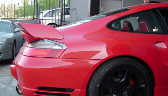

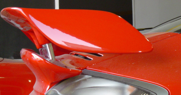

You can't extend the range of the wing as that is determined by the stroke of the hydraulic cylinder.
If you made an adapter to raise the down position of the wing, then of course the wing would be higher in the up position.
Before you do this, it would probably be easier to put an add-on GT2 wing on the car. If you do this, I would add more down force on the front to maintain the aero balance. At a minumum, I wouls add the aero lip.
Down Postition
Up Position
Another in the up position
Later, Steve

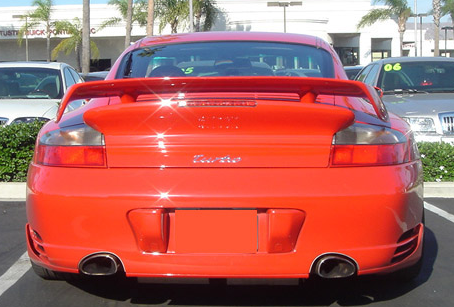

Old Dec 1, 2016 | 03:44 PM
racer959's Avatar
Joined: Sep 2009
Posts: 194
From: NJ
racer959 is infamous around these partsracer959 is infamous around these parts
That looks pretty good. Do you have a pic from the rear with the wing down?
