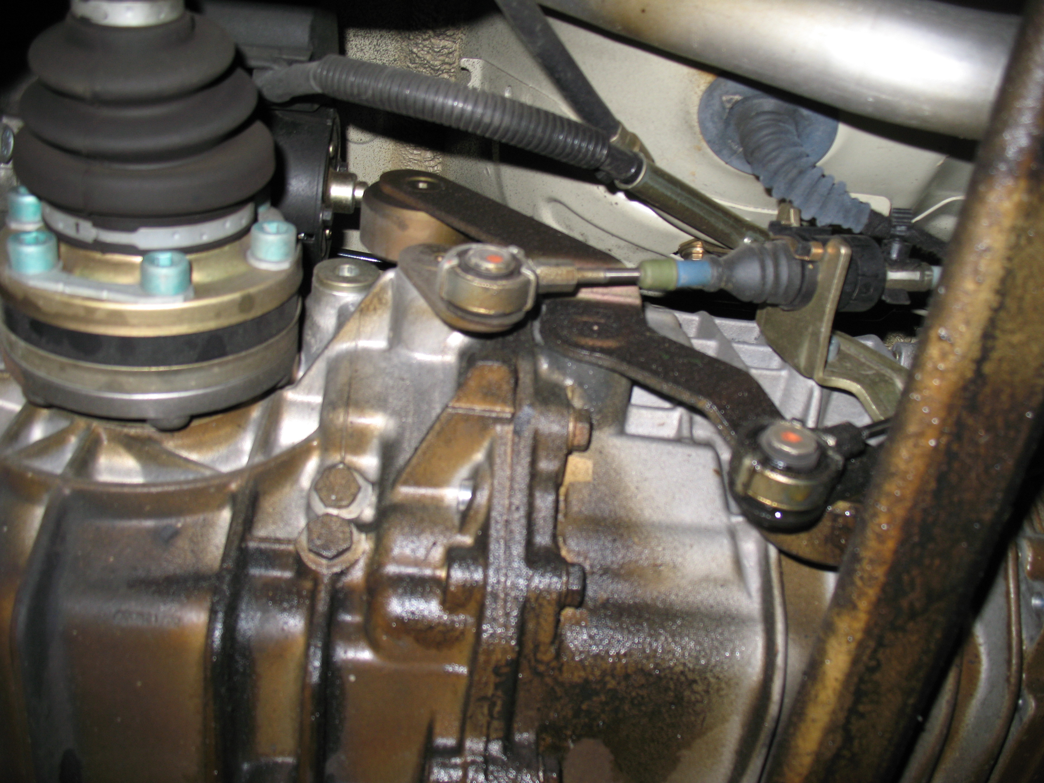

Had a similar selector shaft leak in my 2003 Turbo. Car was under CPO warranty at the time. There was some back and forth between the dealer and the factory about "rebuild" vs. replace. The techs told me to repair the leak would run maybe $6K including R&R the transmission if I had to pay for this out of pocket. While the Turbo 6-speed and the 996 NA 6-speed are different transmissions they share alot of parts and this includes the seals.
But the factory decided to replace the transmission and that was that. I've supplied a pic of the leak.
In case you are not aware, the clutch control shaft needle bearings/dust caps should be replaced whenever the clutch control shaft is disassembled. Also, the tech always replaces the metal o-rings that seal the turbo to the exhaust manifold.

Thanks Macster! Yes, that appears to be the same leak as mine. Its wet in all the same spots.
I can stomach $3.5k to get this done... so if an indie can do it for that, they can do the entire thing. If higher, I'll remove the transmission myself to save a few bucks.
