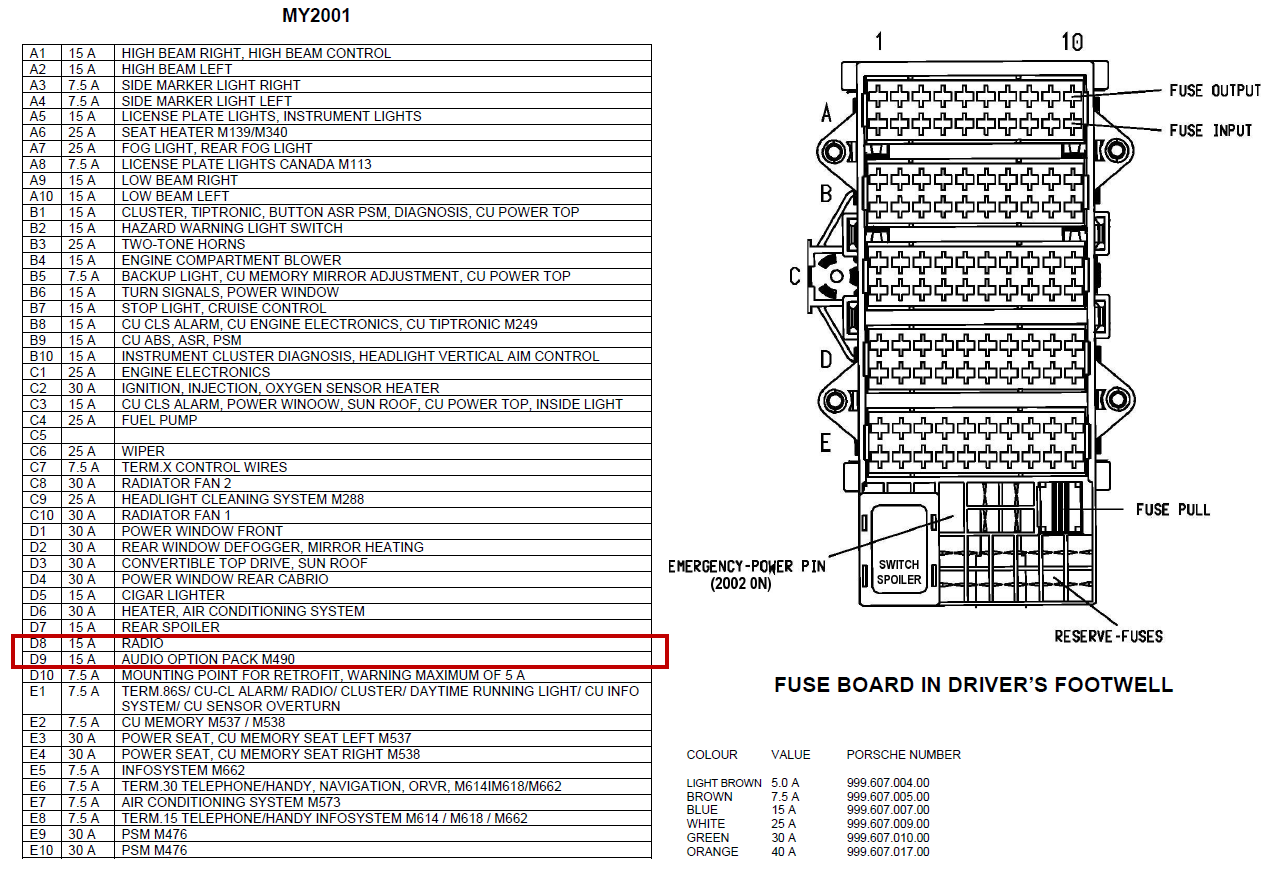

This might help... Most years are close to this, but if you have a different year, let me know and I'll post the right one...

Yes, there is no separate entry for the amp on the fuse panel - the amp must be included in the "radio" stuff. You will see E1 also mentions the radio. E6 is the Nav system. If the amp had its own fuse, it would be listed there.
Edit: You may want to check with a voltmeter to see if power is getting to the amp...

Followed Macster rec and removed the fuse and let it sit for a 30 seconds, put it back and volllaaa I have my radio sound back.
Thank you slider for showing which fuses to pull I pulled both, lost my pre-set stations and had to redo the clock, but all is well.
