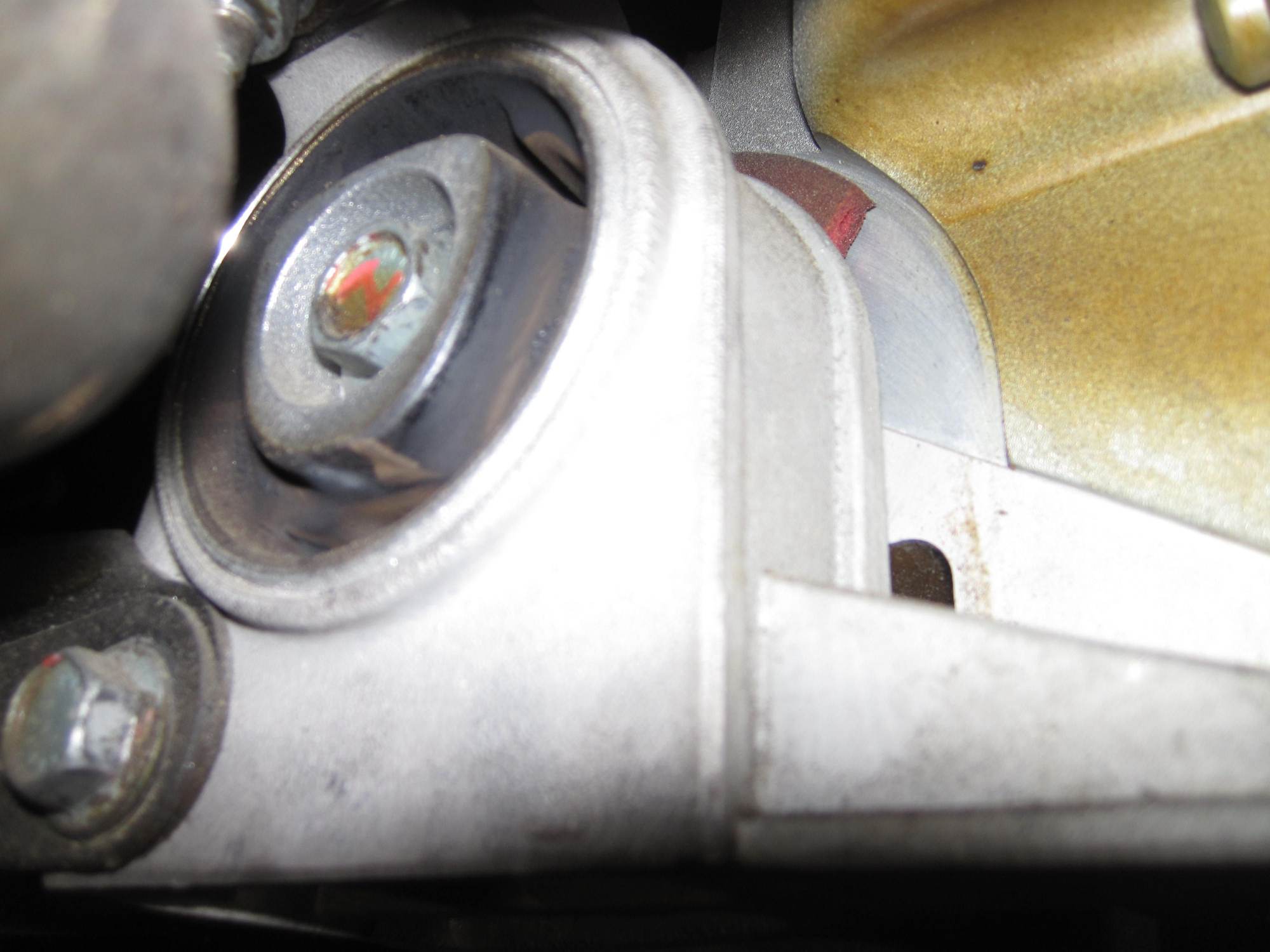

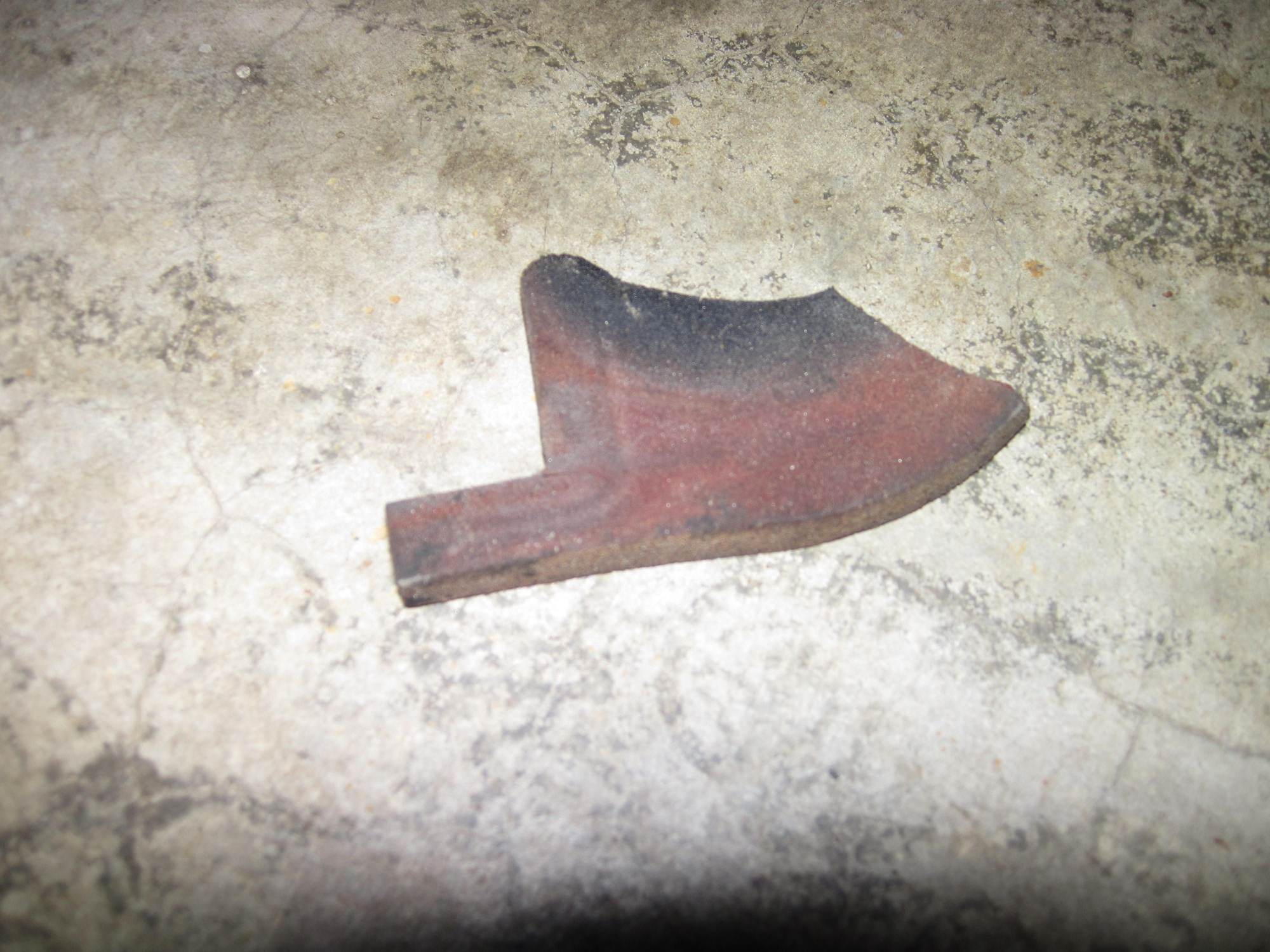

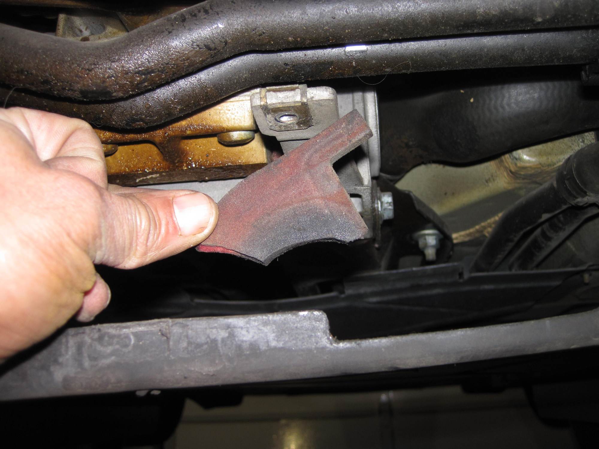

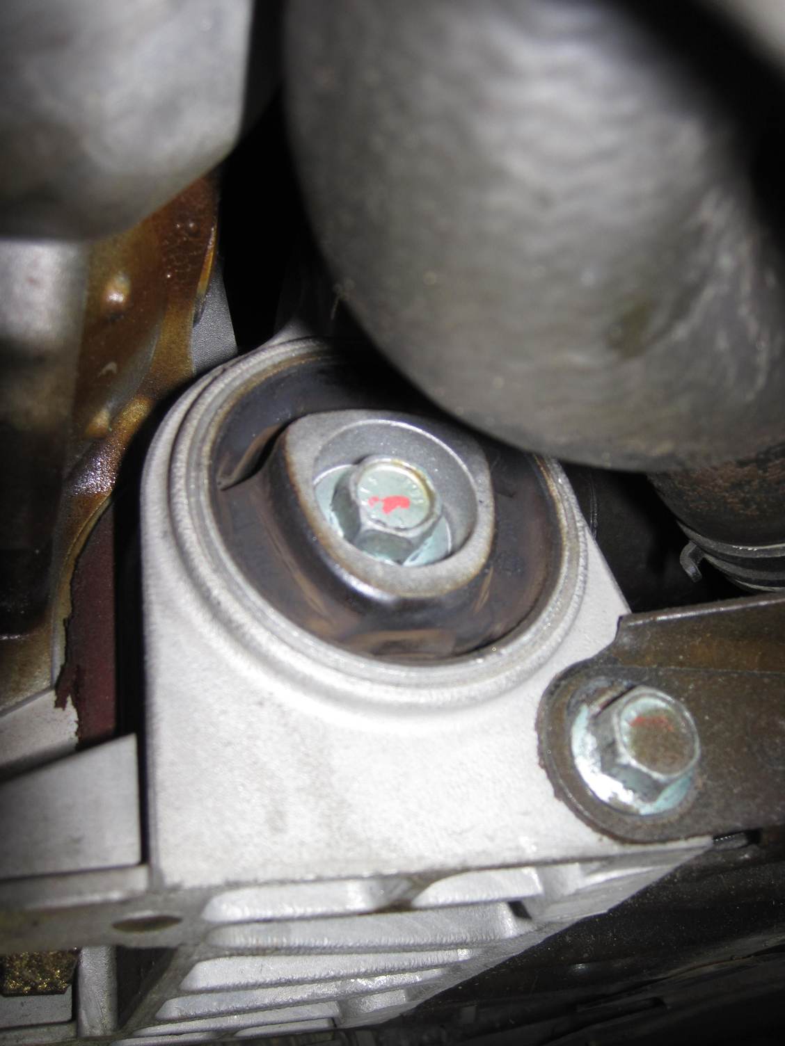

well i'm in it now. while I was in there I noticed that the red bushing that's part of the motor mount has cracked off. can anyone tell me if just the red rubber bushing is replaceable or do I have to do the whole shebang.

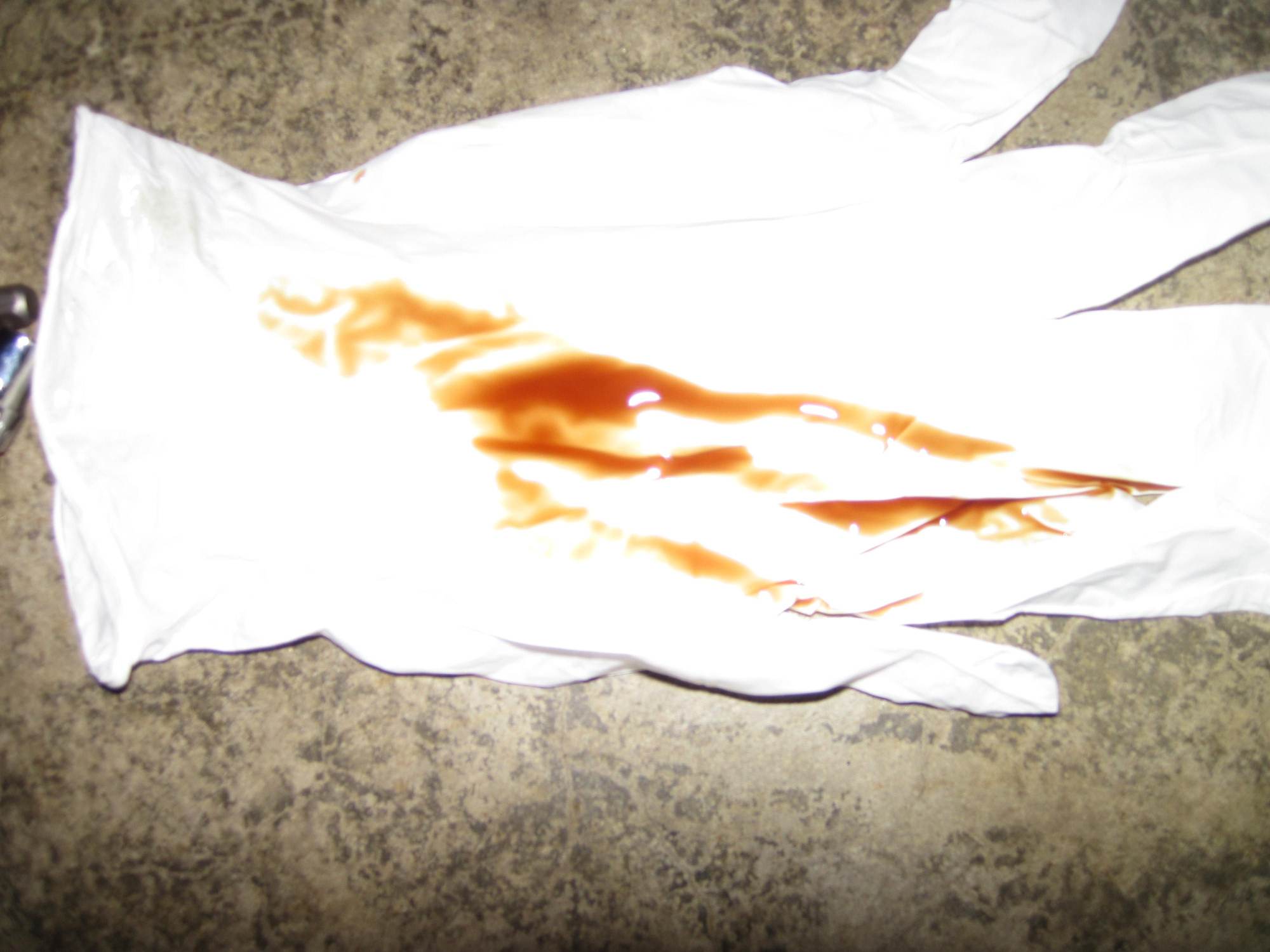

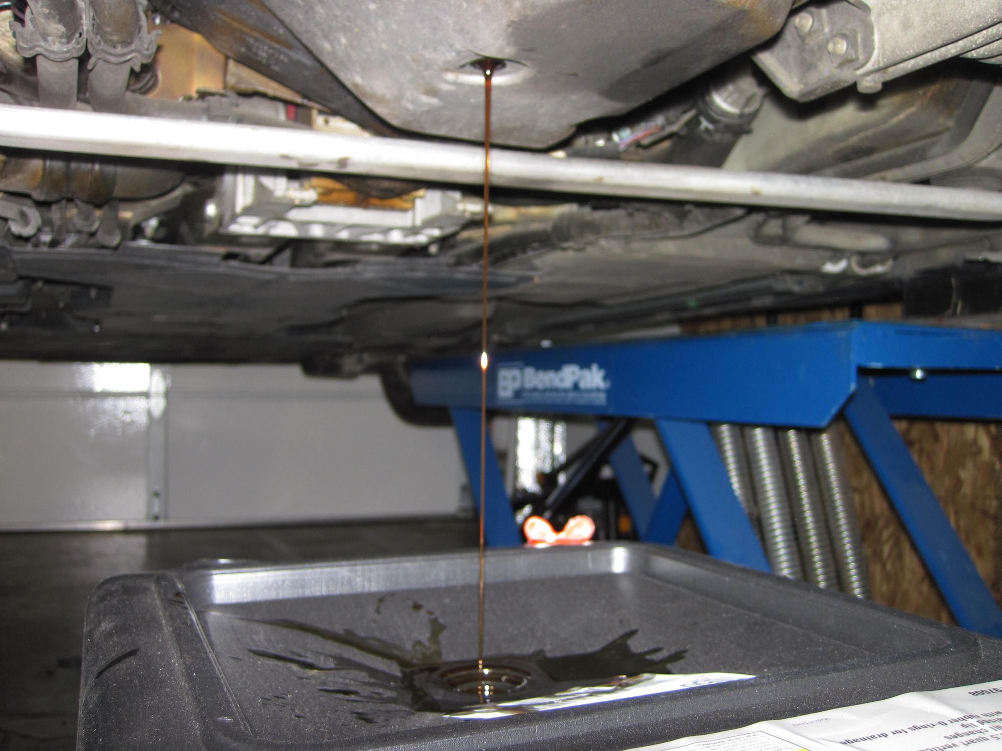

fluid looks pretty damn good though. to bad the damn gasket is leaking.

That doesn't look too bad. Only about 4 quarts will come out. Most all stays in the torque converter. A temp probe should be used but it is not the end of the world if not. The red part is an accerary mount stiffener. Not a problem.
so would I replace the stiffener?? if I can find it??? I'm gonna check the parts manual right now
