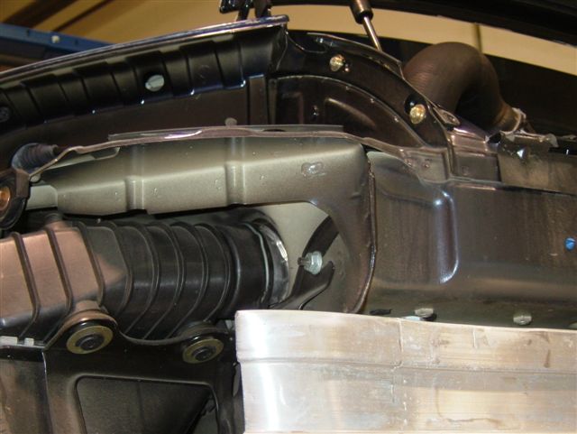

So today we had another perfectly good looking (Midnight blue rocks) 996TT come in for some minor updrages (it already has the Stage II Kit, Europipe Exhaust and PSS9s). We added an EVO intake and the EVO hoses as well as some Billet Diverter Valves. The customer stated that his CEL had come on a few times and then gone off again in the last month or so. James took off the bumper before I even got to scanning the car and this is what he saw (check the two pix). Notice how the boost hose from the y-pipe and intercooler is showing its ugly end? This did suprise me because I've previously only been using the Upgraded hose kit on stage IV and above cars or any 2001 (which has older style hoses). It was already bleeding boost and showing a couple of on/off CELs but either way the timing was good and in went the hoses:

In fact Tommy's GT2 had it even worse... the hose came right out and the car stalled/died

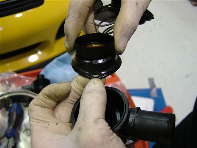

That wasn't the end of it though.. we swapped DV's and decided to cut one open since it wasn't holding pressure properly....
Sure enough here's that crappy Bosch Diverter Valve. Notice the "tiny" tear in the rubber boot? The billet ones have a piston and don't have that issue:
http://www.sharkwerks.com/products.php?pid=30

It only takes a small tear for them to be finished

I _honestly_ didn't think the Stage II cars needed it (other than 01s) but it seems like any cars that boost 1bar or so, over time, do end up with this issue... I think back when the cars were newer and had less miles it didn't crop up as much until a stage IV car.
So I wouldn't say you _need_ them per se but it's decent insurance I remember back at the shoot out, ever single car there used them- no matter what company.
PS I test them out by "swinging" from the bottom one that goes to the IC
