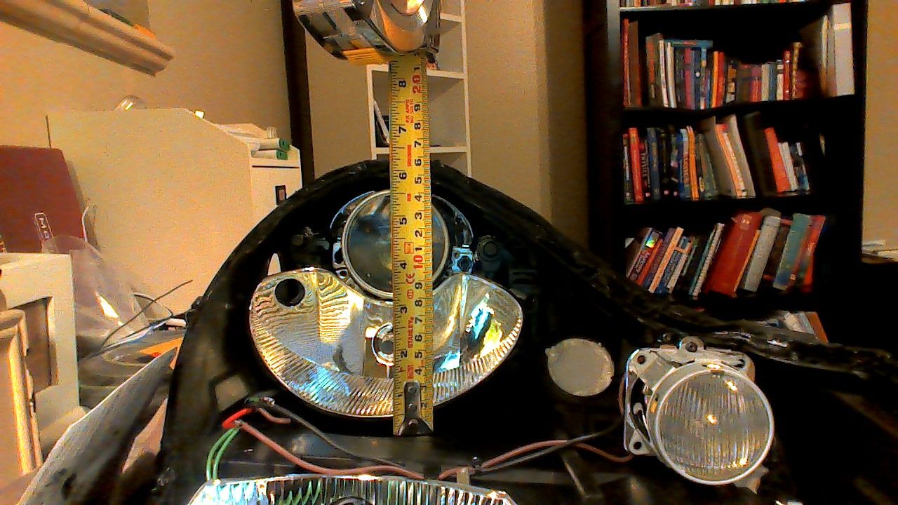

Here is the HID+high beam combo removed. It's really a beautiful design; the mounting points are simple ball/sockets (white plastic in the photo) that you can push on or off.
This unit is 6.5in deep at the top so there's plenty of depth for mounting and wiring a new lamp. Here is the adjusting motor and mount points.
There are a few options for lamps. There a large market for LED replacements of the main light on Harleys which claim to be 5.75 diameter. I really like that option because they have all sorts of designs with LED halo DRL's and built-it LED amber signals. But after some research there's just not enough room in our buckets for those. So now I'm leaning towards the retrofits for classic american cars.
Amazon Amazon
These are simple, have hi/low patterns, DOT approved, and are shallow enough to accept LED bulbs if desired.
They have a 144mm O.D. which is slightly smaller than the harley lights
