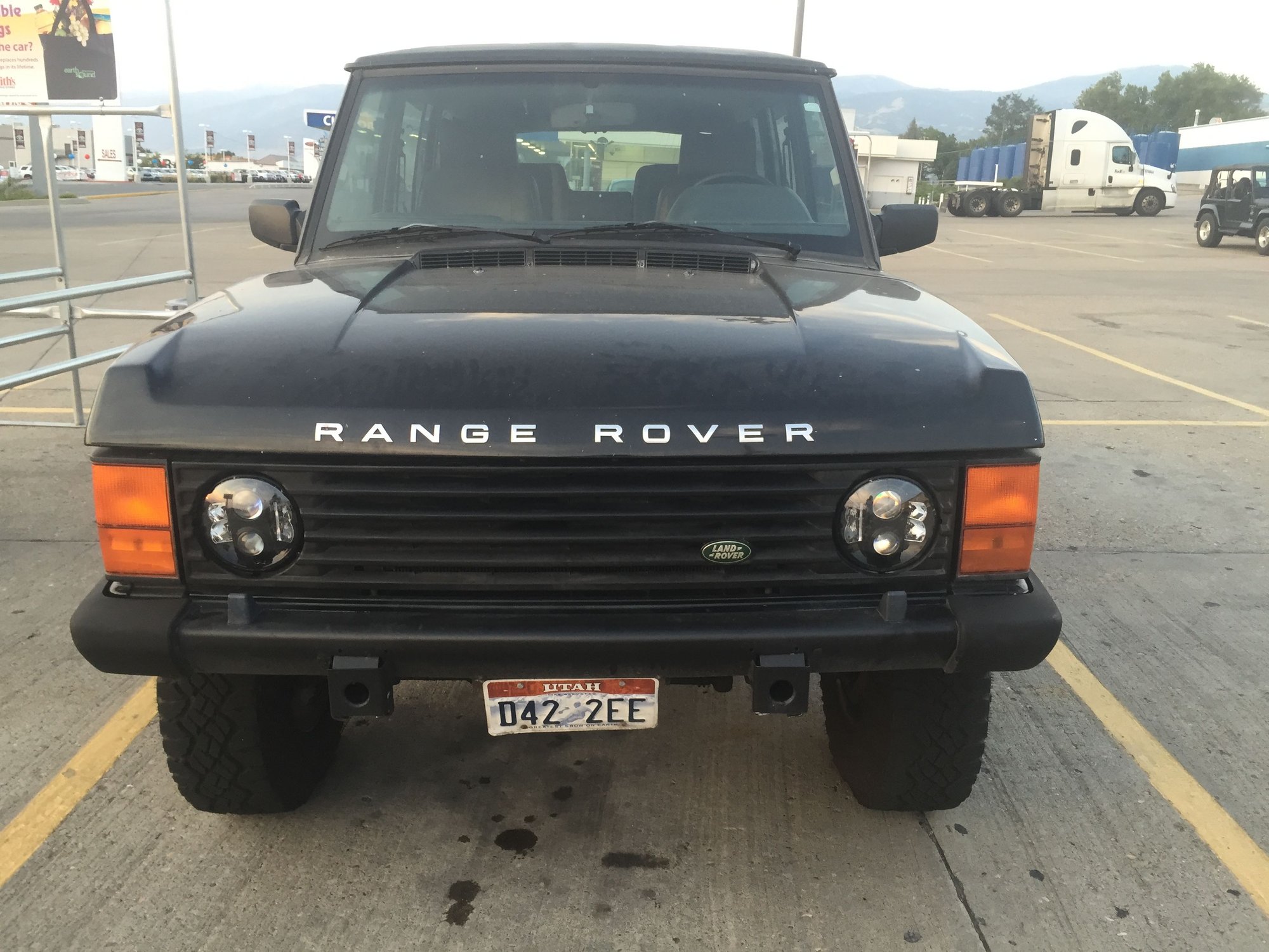

Evan, why do my LEDs Rover lights seem so good? Is just that the turbos have become so dim over time? Is it possible that they really have 3800 LMs on high beam where the JW speakers are like 2800? Really looking forward to your build on the above 996 lights!

It's a 95 LWB classic, I've always had one around, kinda of love hate relationship. This one is going to get a conversion at some soon point to a 680le and ls3 want to get it done before next winter.

Let me ask this, what LED headlights do you have in your RR?

Thats what is kinda funny they were just some no name lights off ebay I took a chance on and for this thing they have worked out well.

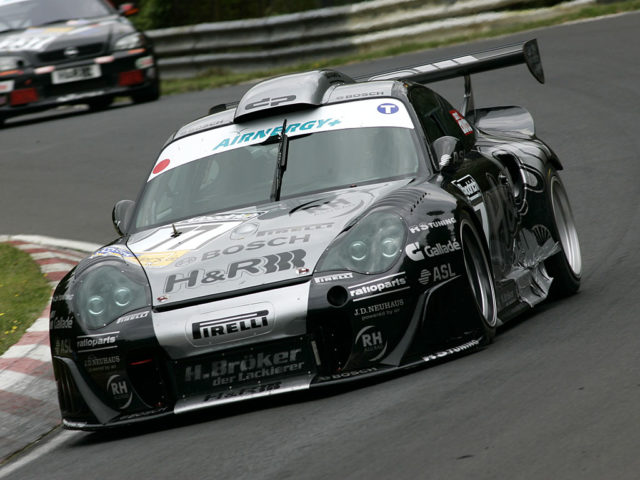

now THIS is a set of headlights i could fall in love with!!!!
Keep ur pants on Bro.
Evan will be replicating a set in Late May for me using FVD lenses & double projectors plus one yellow fog.
Will post the project once it begins.
