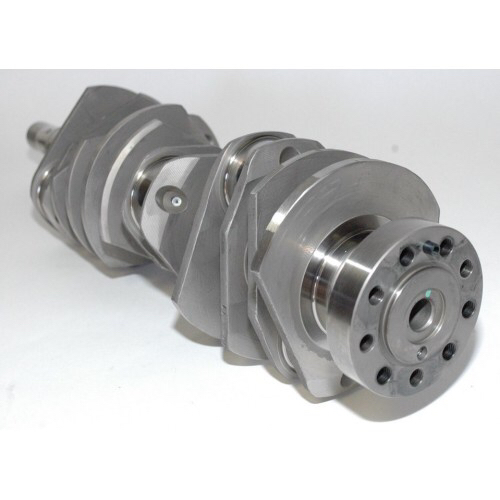

Interesting. This is the only GT3 street crank picture I can find. Looks pretty smooth, but cannot see oil passages. I know the 996 and 997 turbo cranks look like sand cast and are extremely rough.
Again, many variants of these. The 3.6GT3 crank is pictured in the rennlist thread above and it has the rough finish. Don't quote me but I believe the smooth Motorsport crank is what went in the RSR and variants of it also made it into the later generation GT3s. The 4.0 has a totally different crank. Trying to decipher all the various part numbers that went into all the different cars will give you a headache.
I don't know, it just calls it a 3.6 crank. Seeing they offer the crank for GT2 and GT3 and without a part number visible in the pics of the 3.6 crank it is hard to say for sure. The porsche parts catalogs call the street/cup/RSR cranks to be the same up until the later 997 cups and RSR. And the -92/94/95/96 are all superseded versions of the exact same part. Without any 996 GT3 street crank pictures i would venture to say that the marketing pictures GMG provides could in fact be a turbo crank. One thing is for sure, our cranks do have much to improve upon.
Did a little more digging though pet. Looks like the RSR/Cup/GT3 3.6/3.8 76.4mm cranks are basically the same thing. The 04 RSR catalogue shows it as a .92. The one we put in is a .95 if I recall. That is what is listed for the '12 3.8 997Cup. It does have a smoother finish than the .92 I've seen. I'm not sure if Porsche tweaked the cranks a little or improved the oiling thought the years as they updated the last number. They may have but I have no idea. Maybe the difference in the finish is simply due to different suppliers through the early to later years? I would assume that only the last versions of the crank can be ordered now. Interestingly, the 2011 997GT3 pet shows the crank for the 3.6 as a .93/94 and on the next page for the 3.8 as a .95 which would seem to indicate some type of minor difference. Go figure.
