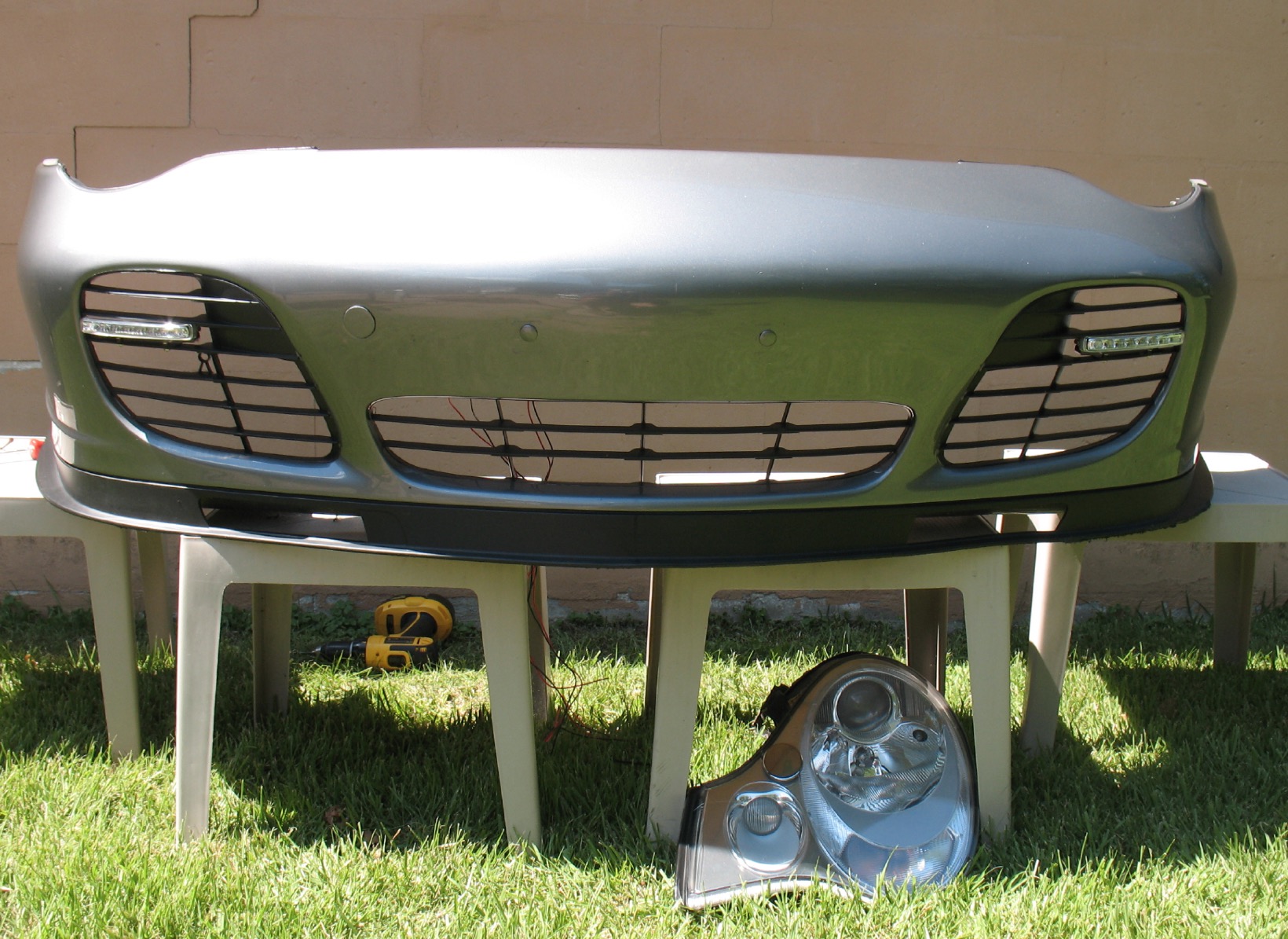

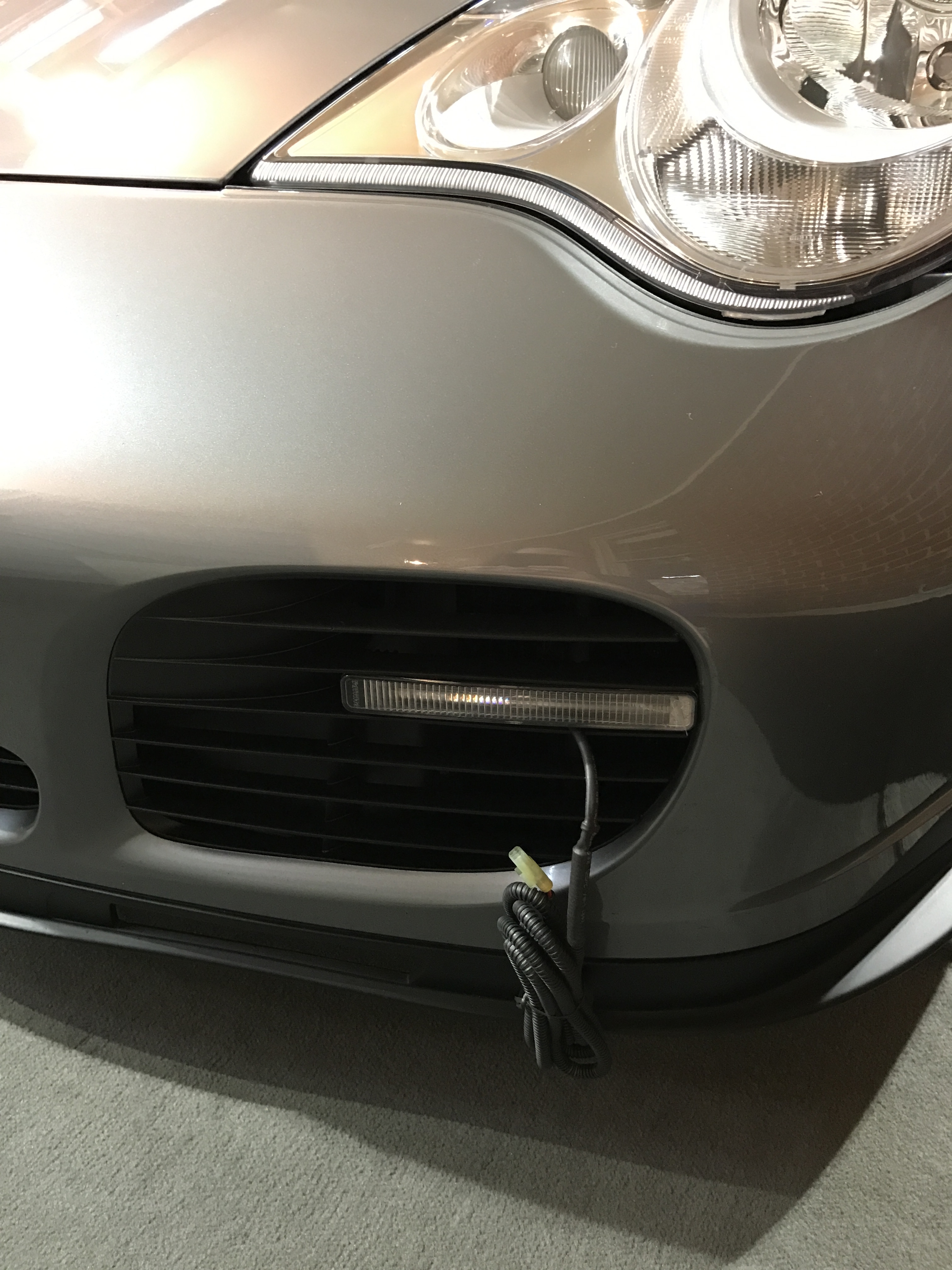

I am installing a set of LED DRL (Philips DayLightGuide) into the radiator inlet areas on my OEM 996TT bumper. It appears that the lights themselves will be a great fit. I am discovering, however, what most everyone else already knows... that there is no way to run the cables with the bumper on the car. So I am removing the bumper. Has anyone else been through this and can recommend a good direct path to follow to get the cables up into the battery area? I didn't want to drill holes in the radiator boxes but I'm running out of options. Will it be obvious with the bumper off? Yes, I need to clean the radiators anyway...

I took off the bumper cover to do this job and I remember there was a grommet behind the bumper reinforcement that I used to get the wires into the trunk area. Never drilled any hole.... I also remember taking the power from the wiper nozzle heater.....

Make sure you leave yourself enough extra wire that you can put the bumper cover on the ground without having to disconnect the wires. After installing the lights you will still have occasion to remove the bumper and you won't want to fiddle with the wires every time.

Very good suggestion from slider, exactly what I did......

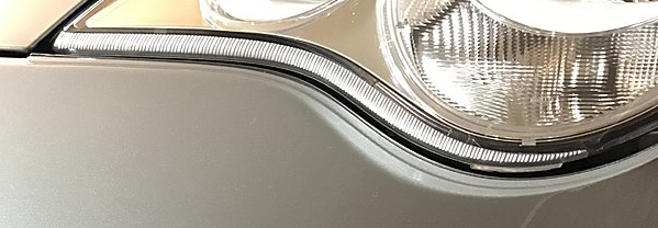

I would love love love it if someone could make some DRLs in the wavy strip at the bottom of the light module (I know it's solid, but the shape and position are perfect!)

Thanks everyone for the help and suggestions! We'll see how they turn out.

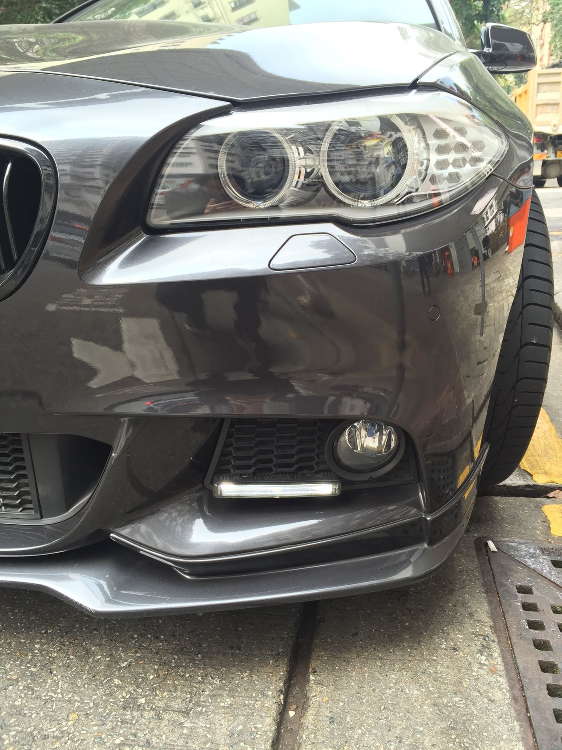

Many bimmers laughed at me when i posted this some years ago
actually bmw is following this idea in its new 5 series
this is a good LED and glad to see this post to teach me how to install it in my tt
