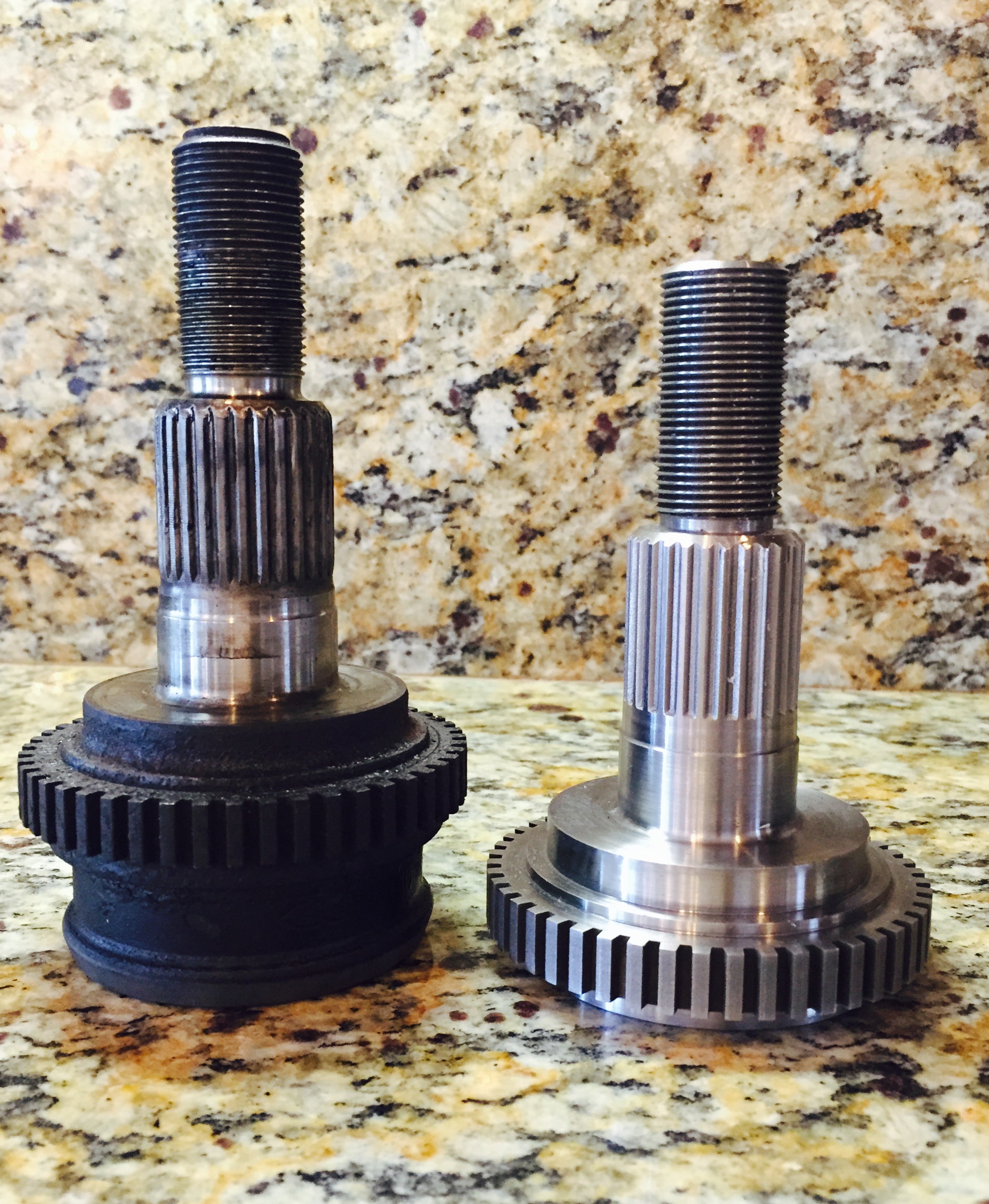

Here's my machined axle deletes vs. stock, I was able to cut down 3lbs between the two. You can definitely shave off some material to save weight.

I suspect those are both steel? ABS ring wouldn't work otherwise...

Yeah, they are steel. One piece vs. OEM two piece (spindle & ABS ring)
