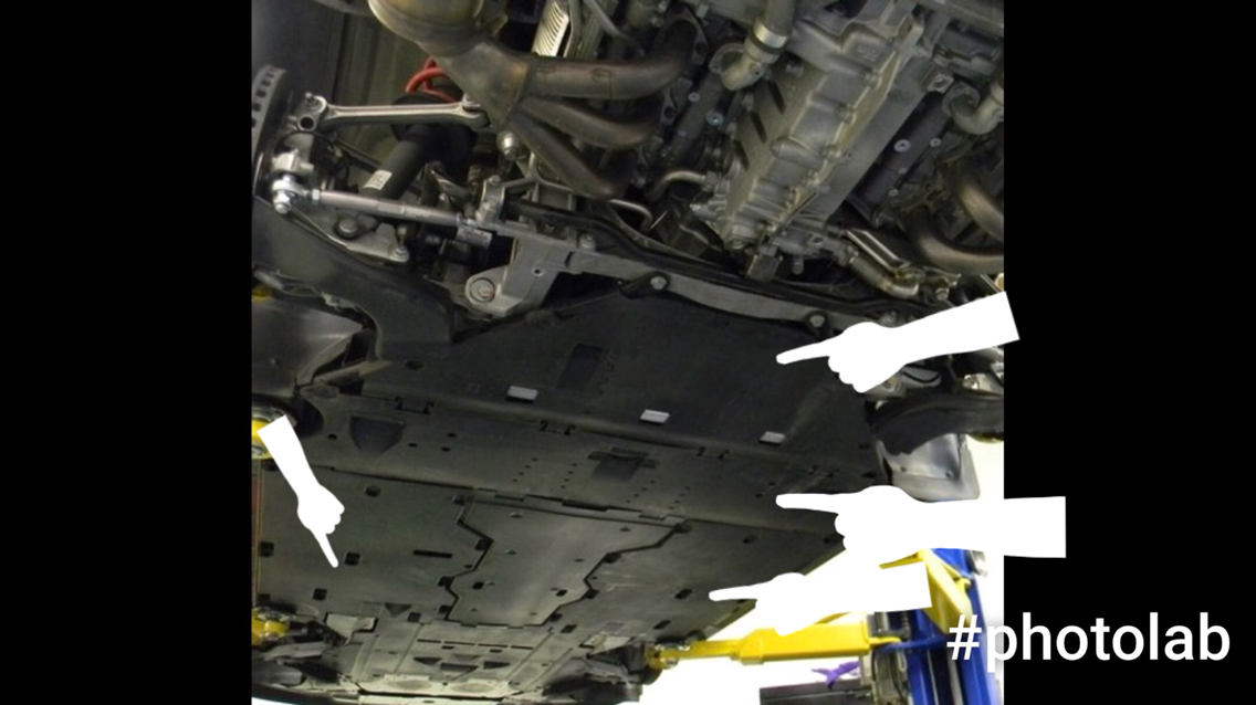

So upgrade these to the 997TT pieces per below picture? The rest remain and/or are modified?

Which parts to buy? The triangle one and the next rectangular one to the front? The side ones that follow also?
Pictures and a partlist would be awesome.

Yes, the last two panels, the triangle and the one prior to it. They make two versions of that one, the TT and the GT3 one. They both have nada duct inlets for caliper cooling and the TT version also has naca inlets on both sides of the gearbox (to provide cooling air to the gearbox). The GT3 version does not have these since it has a gearbox cooler in that location. The picture you have above is of the GT3 version and that is the one I'm using. If you don't have a gearbox cooler, use the TT version. I'll get part numbers for you later. They are in PET. I did not replace any of the forward panels.

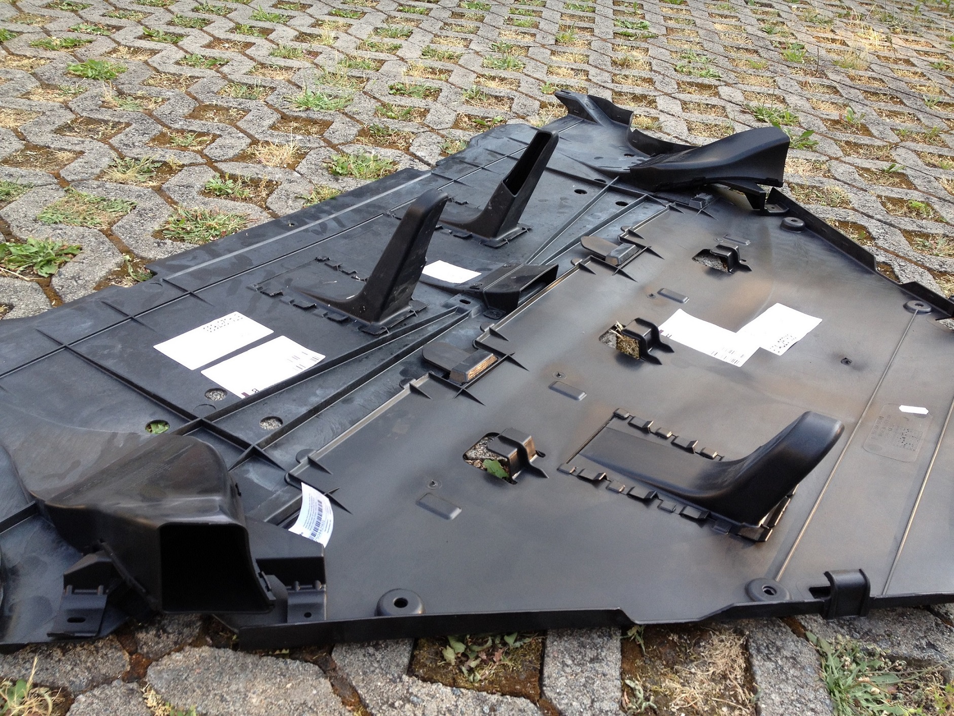

Here are the 4 major parts you need. In comparisn the 996 TT parts look medieval...

Be sure to attach them properly. I mean properly. The noise those two make when they decide to fly away at 220 kph is something you'd want to hear often...
I really do not know what went wrong this spring, but they've been there at speeds of 315 kph without a problem, but now at Autobahn A1 north of Lübeck they departed. There was a very sharp vertical bump (not common on those roads) , but still...
Luckily there was nobody right behind me.
