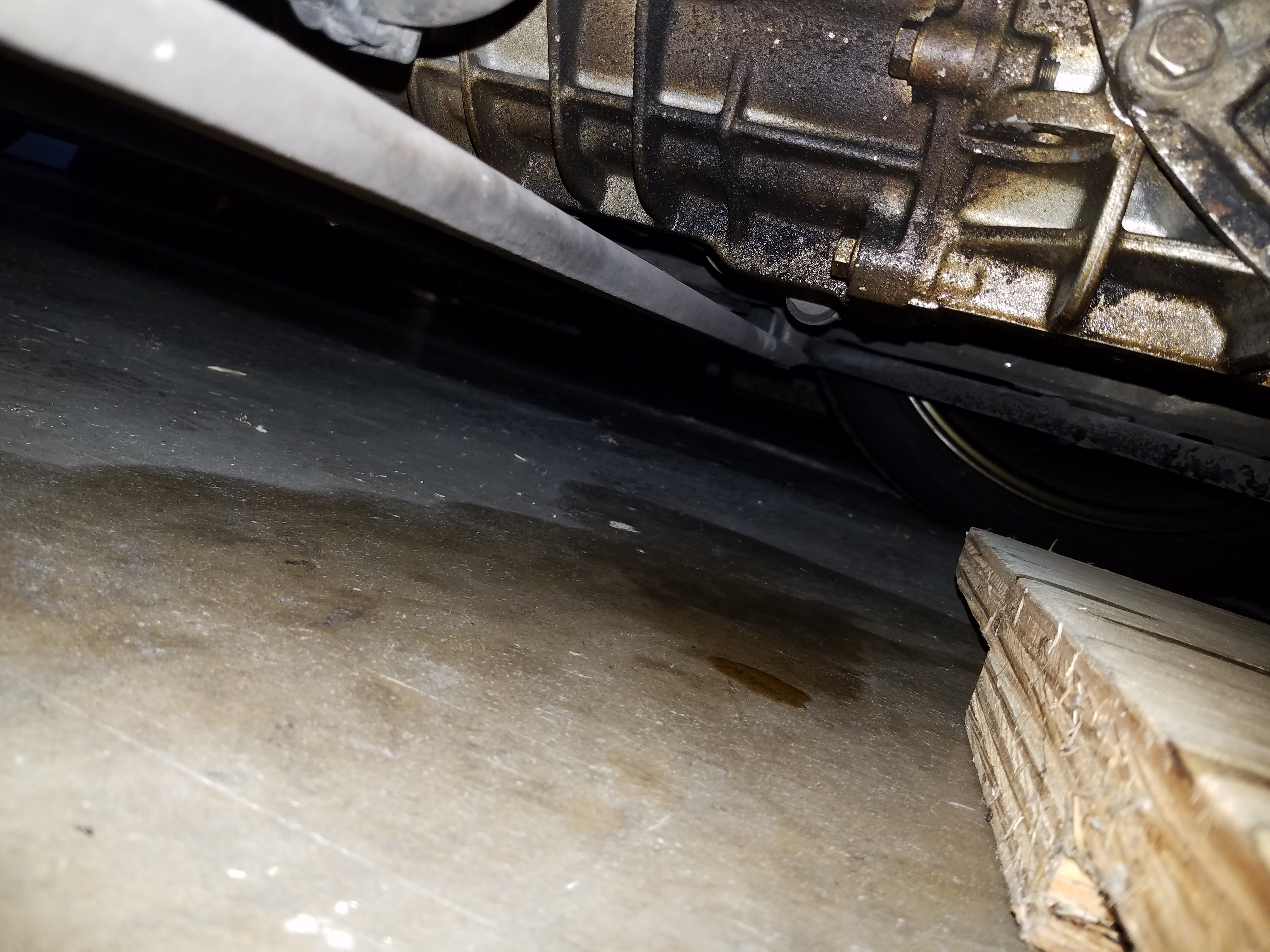

I noticed a few drops of oil on the garage floor this morning. Seems like it is coming from the rear differential. Anyone had this issue? I imagine some sort of seal or gasket. Just wondering how much that will set me back ?
I peaked under there and tried taking a pic.

hard to tell from that pic but could it be your rms? thats 8 hours of labor just to get at a 40$ gasket and when the leak is "visible" and actually leaving drops? it's "time".

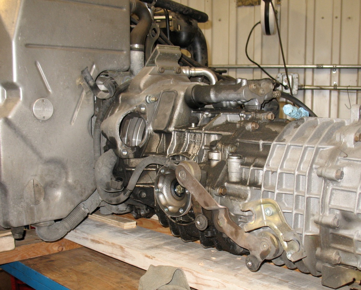

I'll check the drain plug either way but seems highly unlikely. The leak is right in the middle between the rear wheels and slightly to the front of the rear wheels. Oil drain plug as on the side behind the rear wheels if you look at the pic below (for reference, not my car):

Here is a better pic showing the puddle on the floor. Seems to come straight out of the seam, so I think RMS is the correct answer. I also checked both drain plugs; all good there.

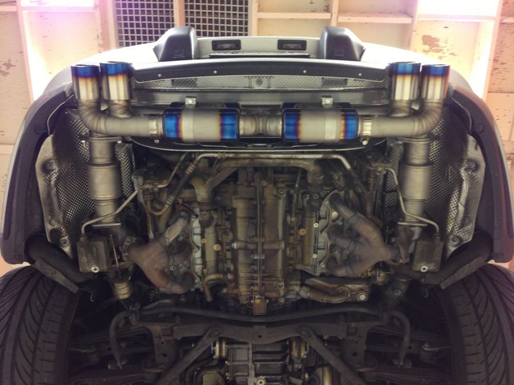

Stebo has a reputation beyond reputeStebo has a reputation beyond reputeStebo has a reputation beyond reputeStebo has a reputation beyond reputeStebo has a reputation beyond reputeStebo has a reputation beyond reputeStebo has a reputation beyond reputeStebo has a reputation beyond reputeStebo has a reputation beyond reputeStebo has a reputation beyond reputeStebo has a reputation beyond repute
[quote=FI_FTW]
Bruh, that is a gorgeous exhaust!! My oh my.
... and there ya have it sorry, but a common point of failure.
