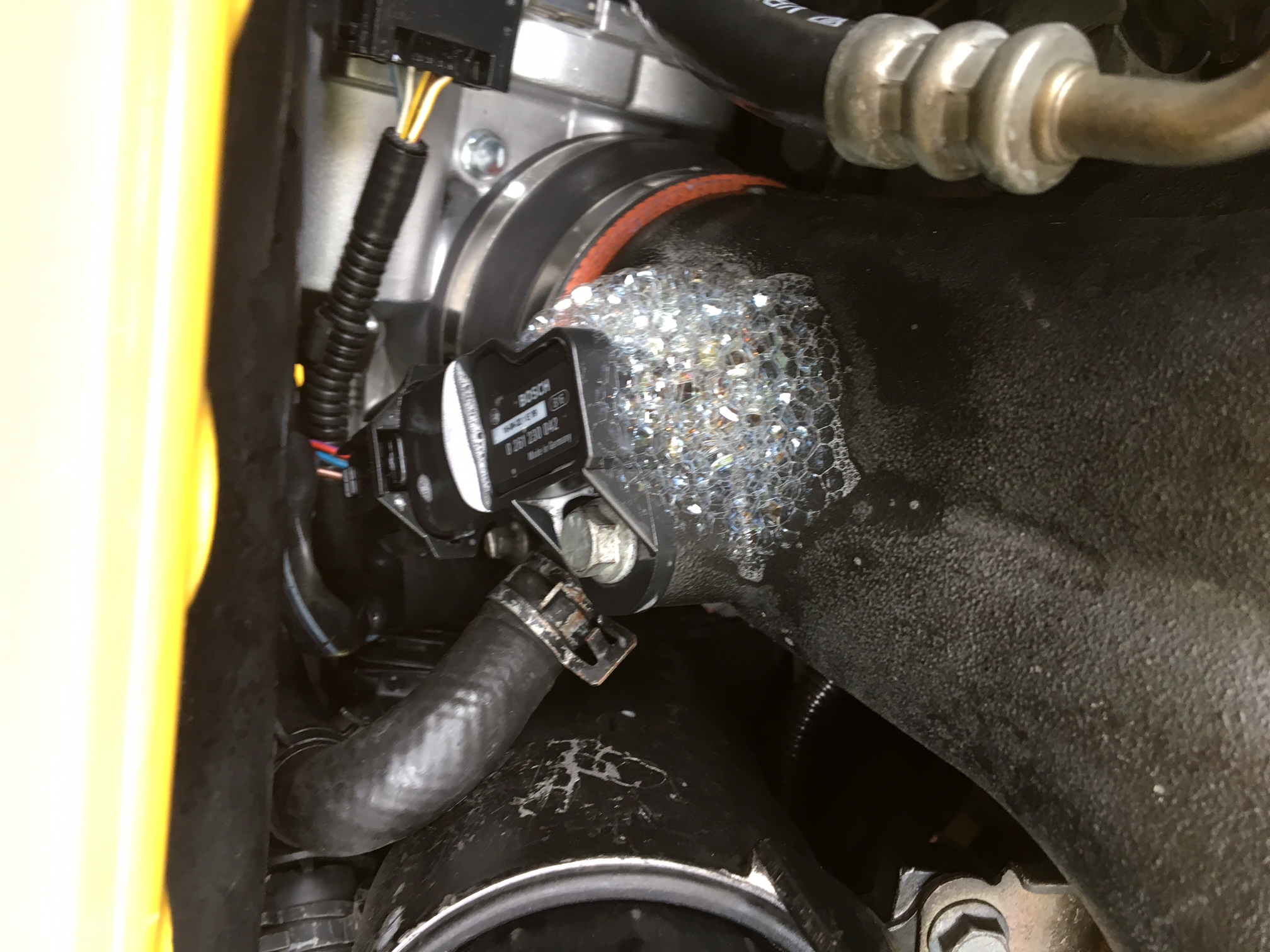

So, I started the following thread a while back:
https://www.6speedonline.com/forums/...eak-stuff.html
I recently finally replaced the leaking MAP sensor, but am having the exact same leak issue with the new one. It really seems like a crappy design by Porsche. Anyone have any cure for this???

I cannot se the part# of this green o-ring anywhere ??? Probably come with the sensor ;-( Take it out, measure it and check if the ones for Volkswagen are the same size : https://www.ecstuning.com/b-genuine-...ing/n90563801/
Sorry just realized you already replace it.....

Originally Posted by 32krazy!
new oring around the sensor and use a lock washer under the bolt it may be bottoming out and not getting tight enough. you could also run a bead of yamabond around the edge of the flange
Thanks!
Yeah JP, it's brand new.

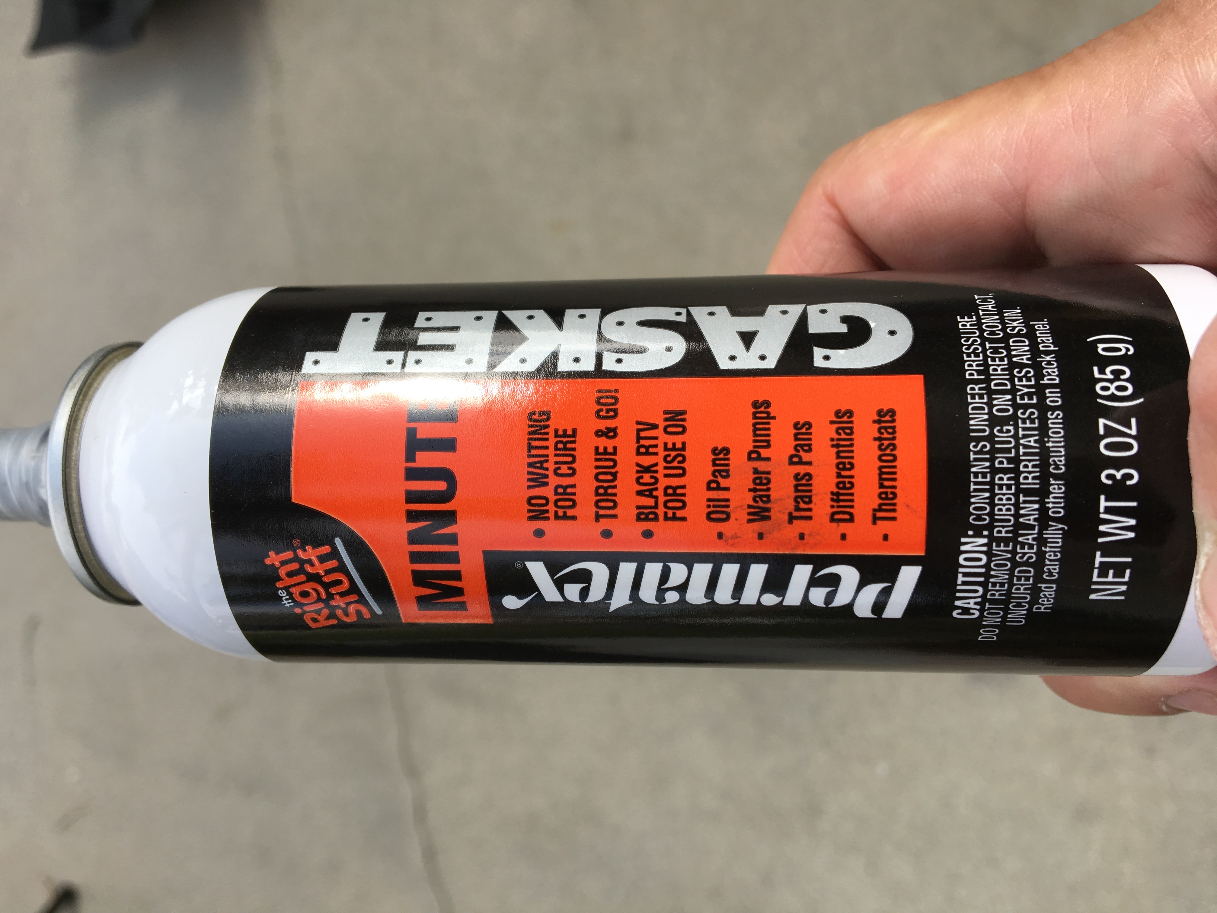

A little of this did the trick...for now!
Thanks boys!
