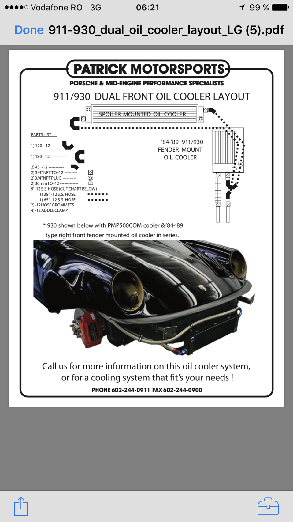

The product has been delivered without install manual or anything like that and cant figure out how to install it as it meant to be from the producer, after some emails they send install guide from older air cooled 911 with the oil radiator to be mounted in front of the car and saying no 996/997 install guide available for my kit. But hoses are too short for that install they indicated, guess the right way is under the car.
Product is 996 307 TOC PMS. - Transmission Gearbox Oil Cooler System - 996 - 997 Trans
Attached the wrong install guide
Anybody having the same kit?

Thanks already took a look into it. If will have to improvise will make it work, but paid for a well built custom kit for our cars and now not having too many options.

Essentially you can make your own. You really just need a cooler, lines, fittings and a pump. I think you'll have to drill the trans to. Then it's just a matter of mounting the cooler. I do believe it's best with a scoop under/flat along the trans.

The Patrick Kit is not really the way to go for our cars as, contrary to what they say, it's not really made for a 996, it's more of a generic kit. We looked at it years ago when setting up the trans oil cooler on my car. It's much easier (and cheaper) to buy the exact parts you need to make a kit to your exact needs. Depending on the layout you decide on, you will need various AN fittings, braided hose, a Setrab air to liquid cooler, a filter, and a pump. I highly recommend a Mocal 17311 gear driven pump as it has high flow capacity, quiet operation, and high reliability. Don't use a Tilton pump that Patrick supplies. The Tilton pumps are diaphragm pump and they they are LOUD, loud enough to be heard with the engine running an open exhaust! I did a thread a while back on my cooler set up for those looking for details.
For those interested, I will actually have the complete trans cooler set up removed from my car in the next 2-3 months or so and put up for sale. It will include everything for a plug and play set up. I'm swapping in a transmission with the OEM GT2 liquid to liquid cooler in place.
