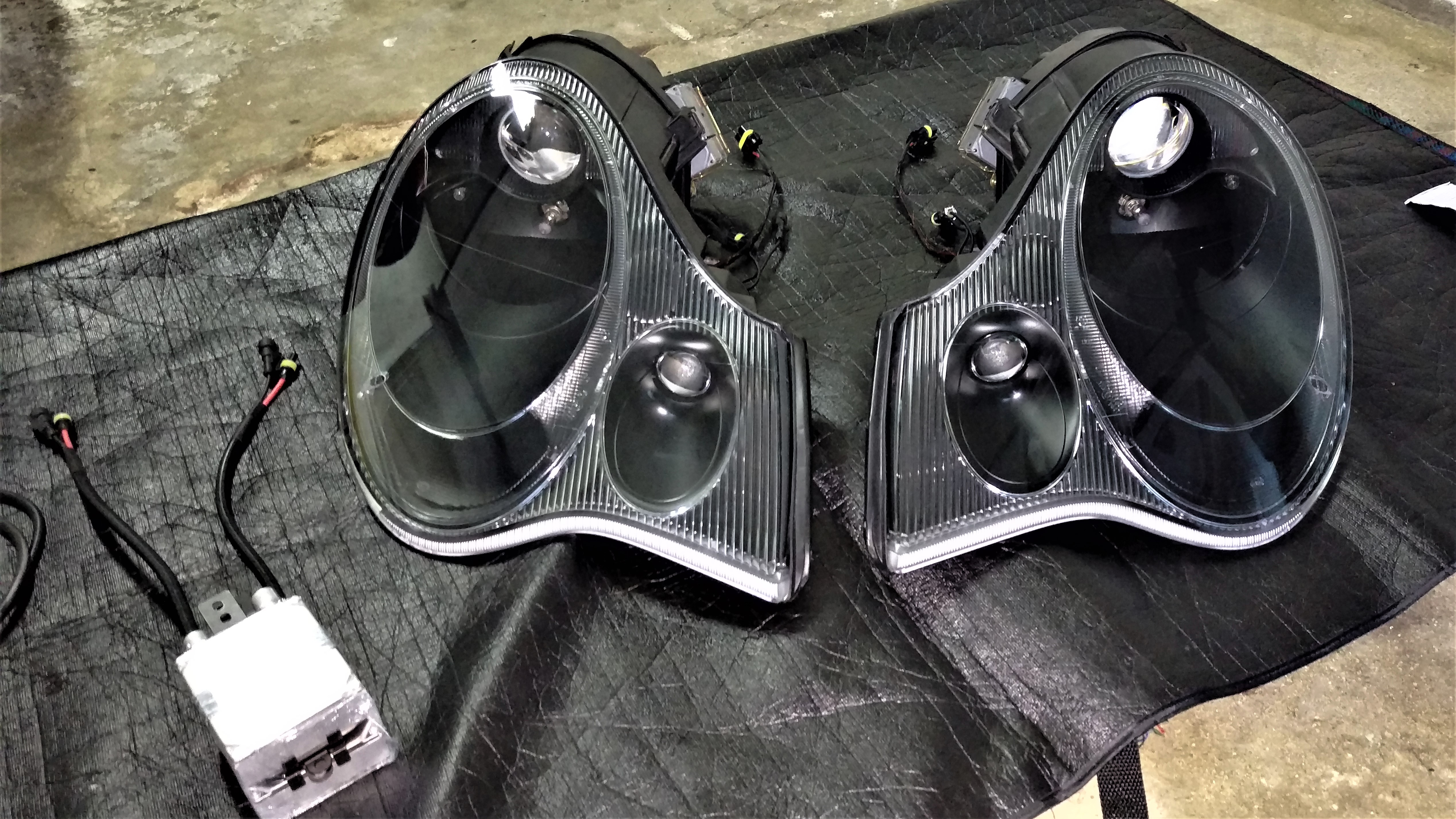

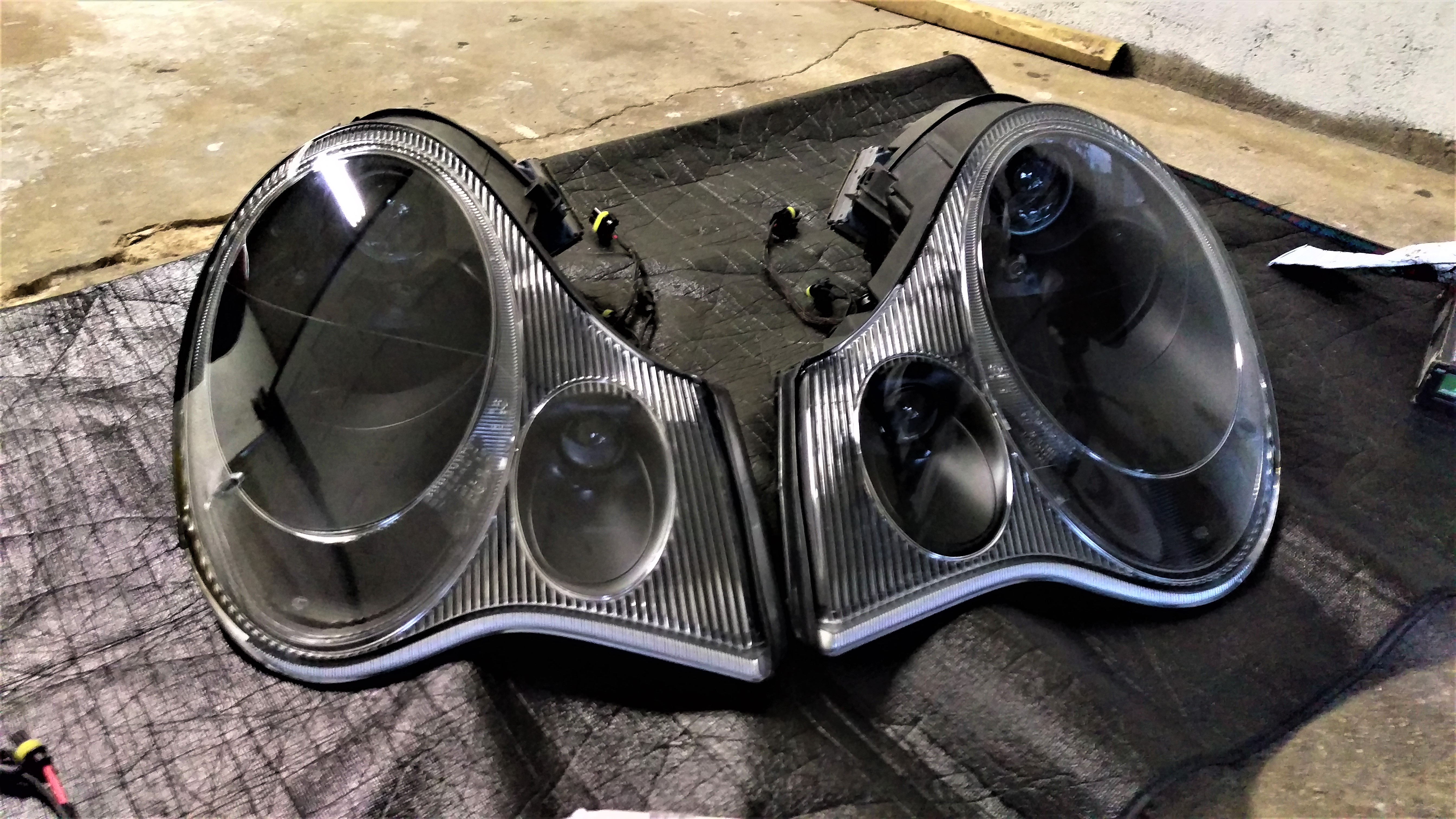

GT3 RSR headlights got delivered
Install pics nxt week
