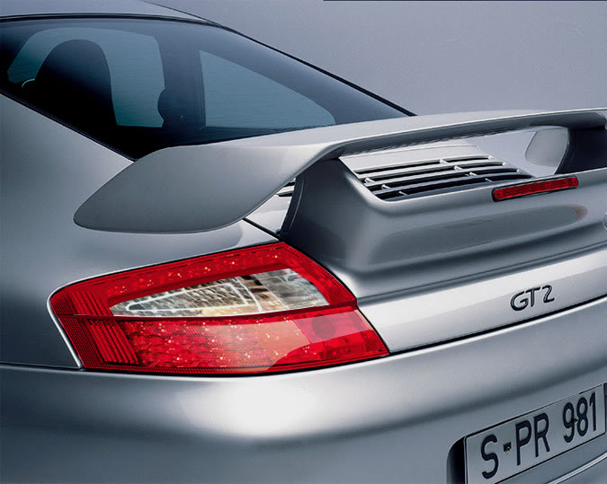

Originally Posted by 32krazy!
now if you can just get them to do a set of oem tailights in led i would be interested !! something that doesnt look aftermarket 997
Agree with this.... something like this would be perfect....

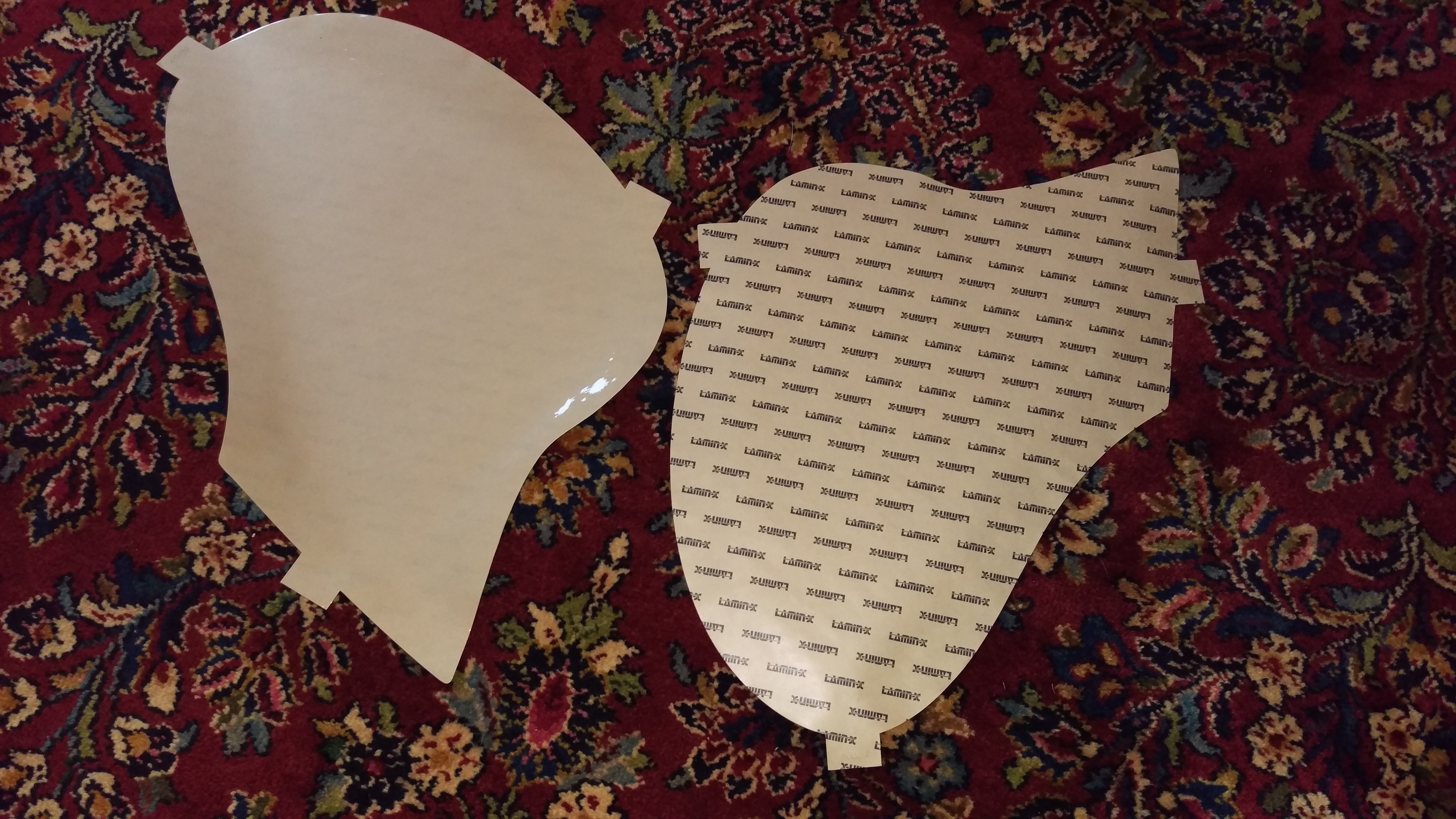

GT3 RSR lenses are for GT3 RSR race cars. They are quick mounted & changed with a single screw. Hence the drilled hole from the factory.
No biggie- its small & easily covered & sealed with 8 ML Lamin-x headlight film.
That's going on ASAP to also protect the crystal clear lexan lenses.
