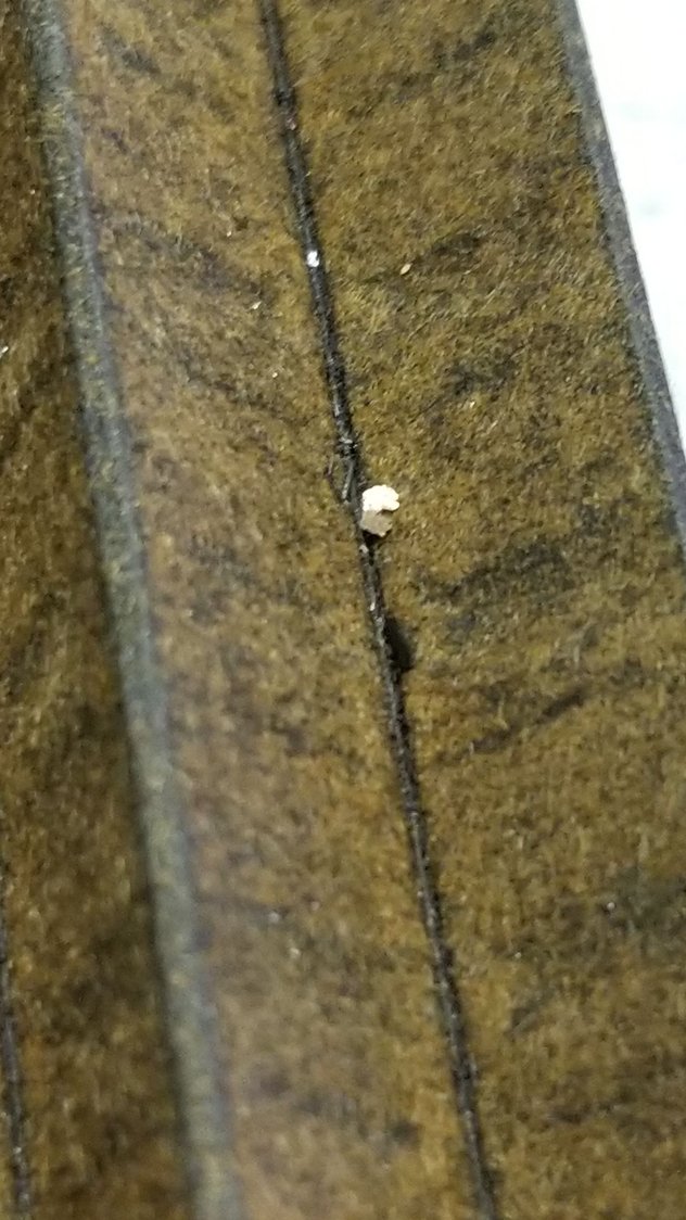

Broke valve spring. I think.

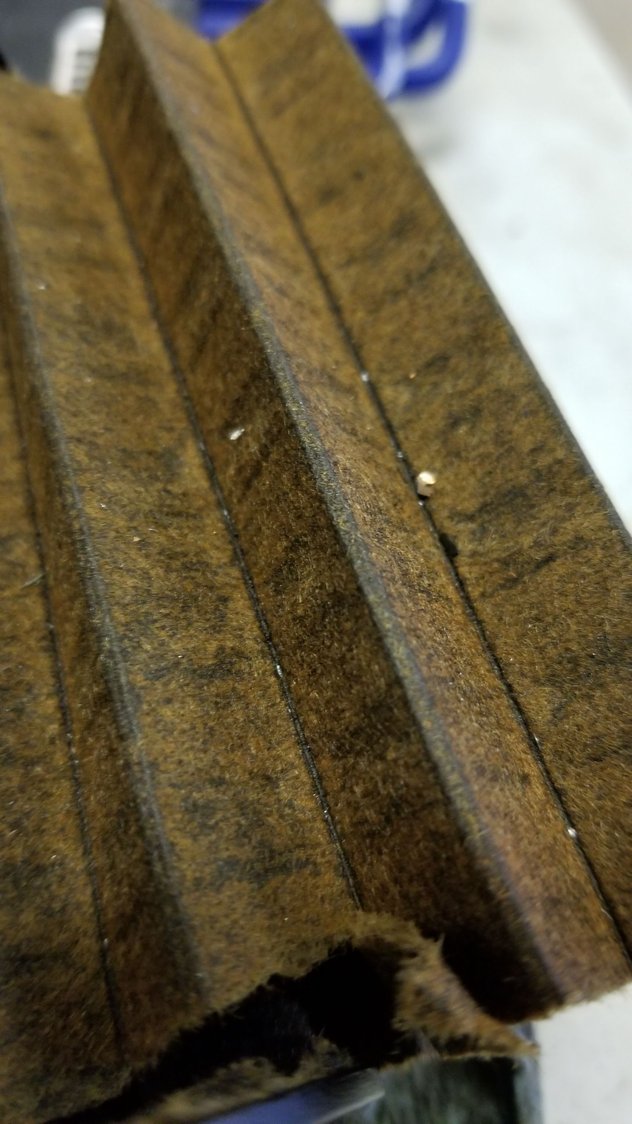

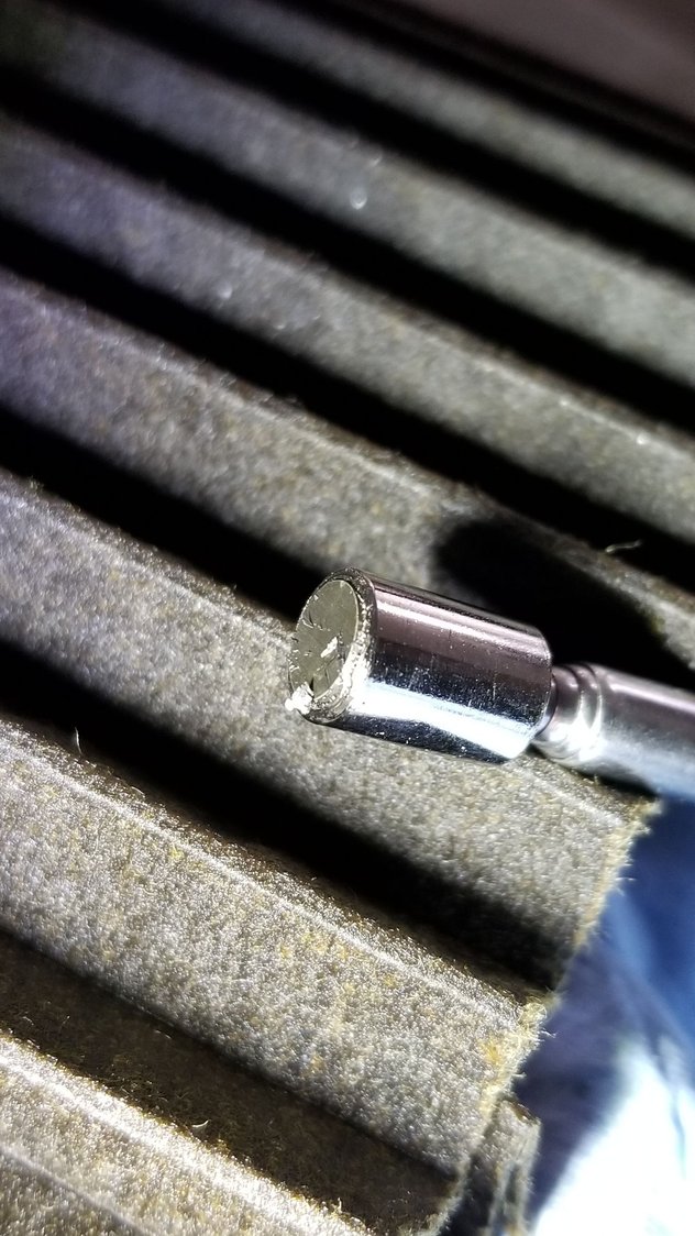

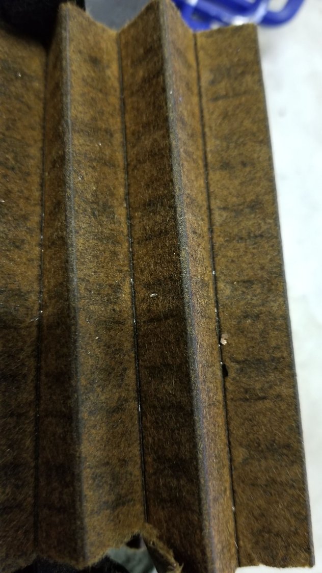

Yes we will do it here. I happened to have a friend that is a Porsche builder in town. I will buy all the tools. I just checked the filter now that it is reasonably dry. I ran a magnet on a few pleats. It's both aluminum and steel.

That does look like a spring piece. Maybe you are right. I'm sure the pump is shredded, it's pretty big. Be sure to post up what you find.

Yes I will definitely post a bunch of detailed pictures.

A few more pictures when the filter is dry
