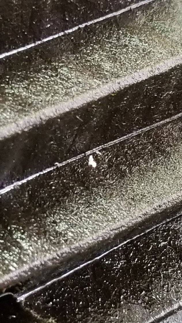

Dissent look good
Reply
Sep 28, 2017 | 05:17 PM
You might have caught it early enough. Is that aluminum? Those don't look that big, though you won't know until you take it apart. The bigger pieces tear up the oil pump.
