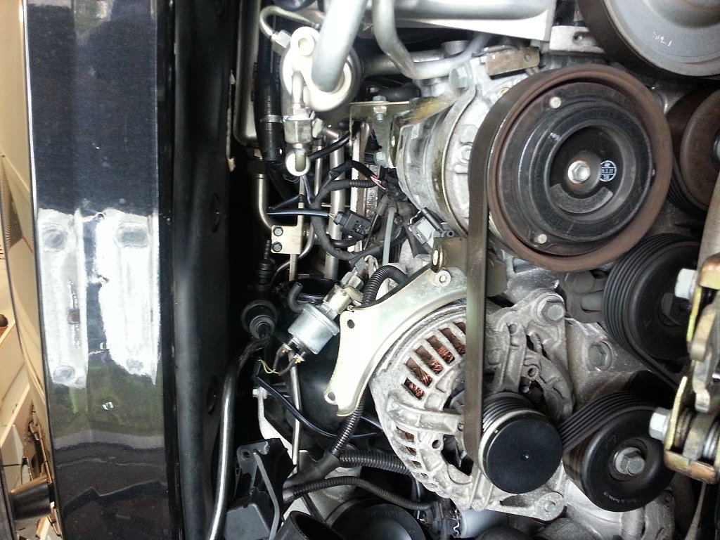

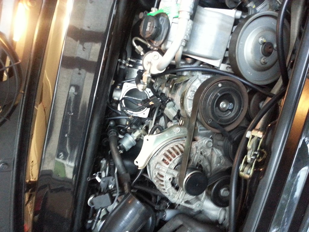

Getting ready to remove the plenum over the long weekend. Hope all goes well. Still have to remove the oil filter housing then diverters and throttle body. Any words of wisdom out there

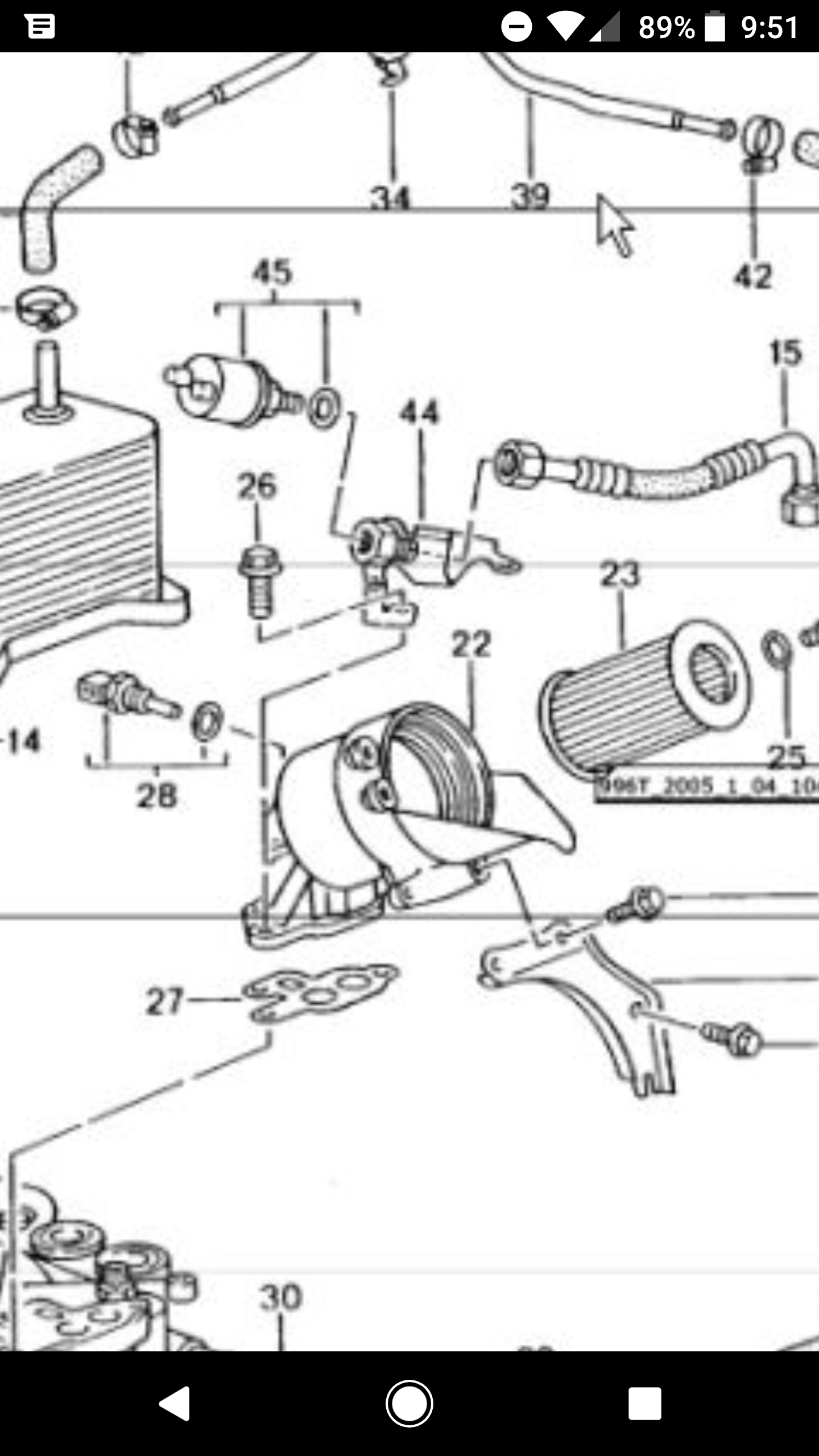

Look at my pix. You can remove the housing for sure. You have to take out the DV's and you'll see more.
I would suggest ordering the housing gasket.

I changed my oil at the same time, so I took it out but I don't remember if you needed to.
There are 3 bolts and a gasket. Buy the gasket.

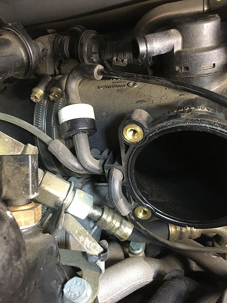

Also, did you back out the brass fittings on the IPD and use some Teflon to seal the threads?

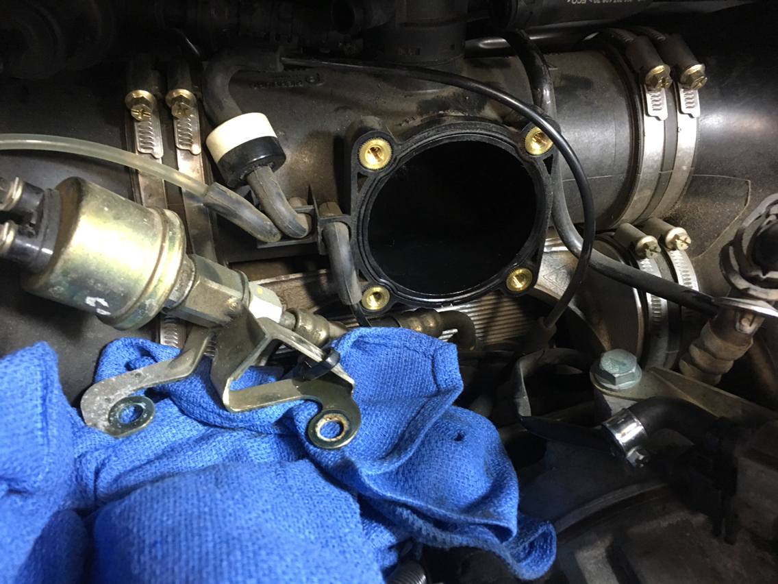

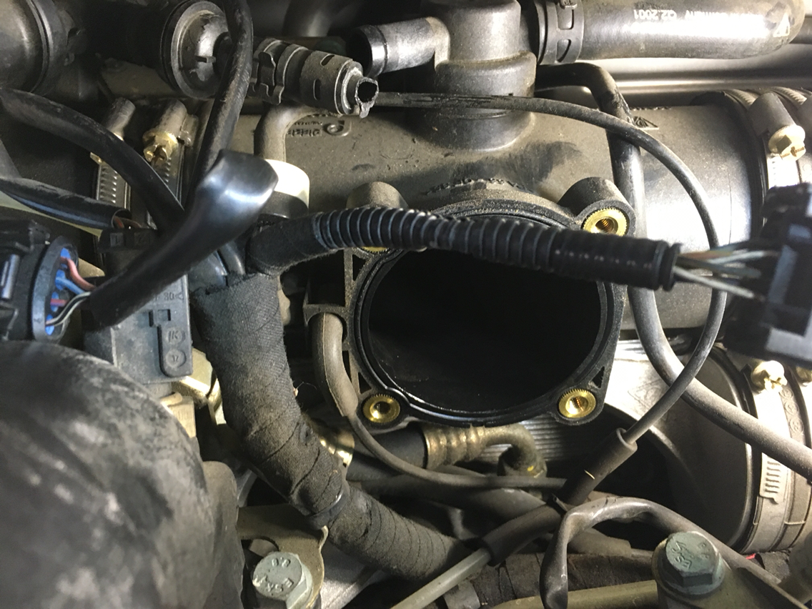

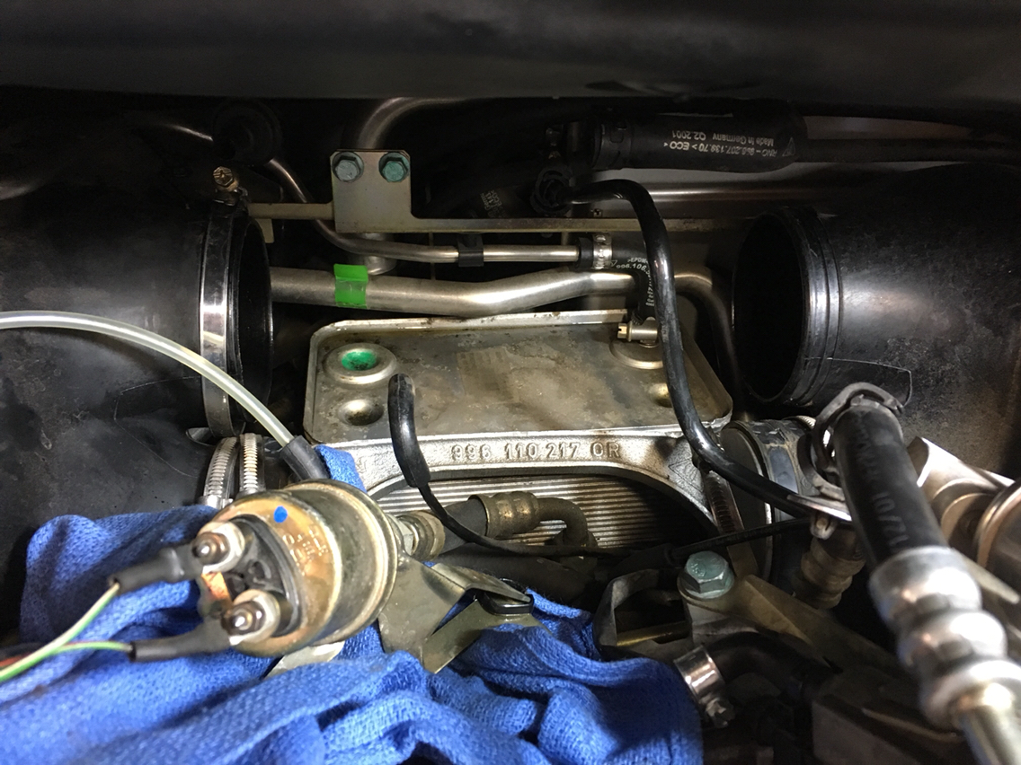

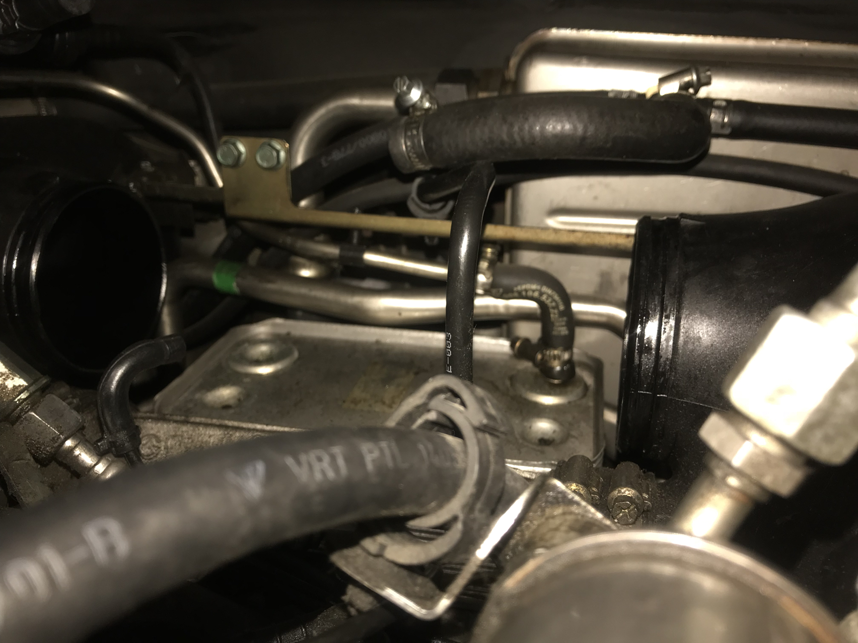

A few pics that may help when I removed my plenum. You can remove the oil filter housing - the blue towel covering the oil flow port after removal. Just be systematic in removal. Ensure you take pics. The plenum is a pain. It must be perfect when replacing as all things have to line up. Good luck! Brock

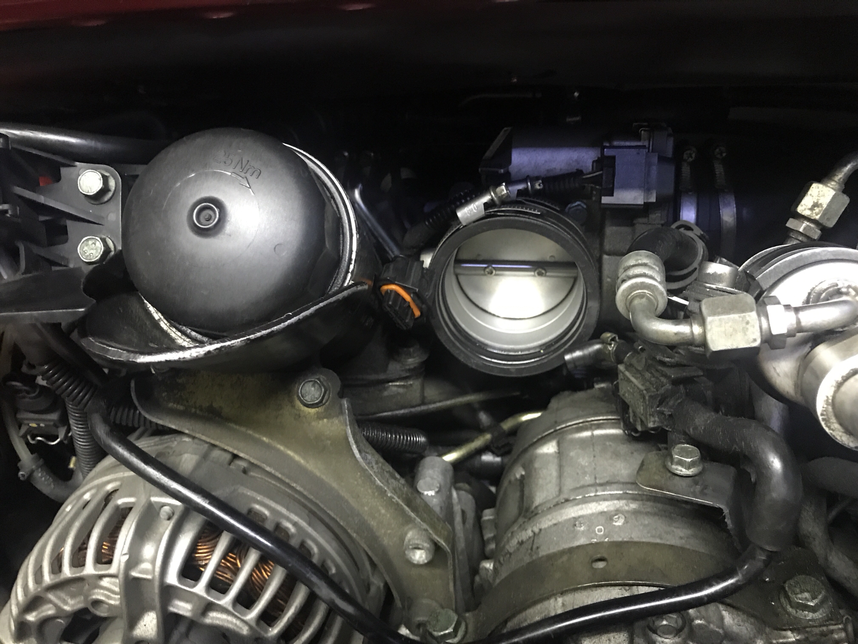

Well got it out. And I didn’t take the diverts out or the oil filter housing. Just slipped right out. Maybe I’m just lucky. I did drop the motor down about 2-3 inches and had a sh.t ton of space. Now just waiting for my IPD to get here Monday. Didn’t even take the cross bar out.
ID:	516667   Click image for larger version
