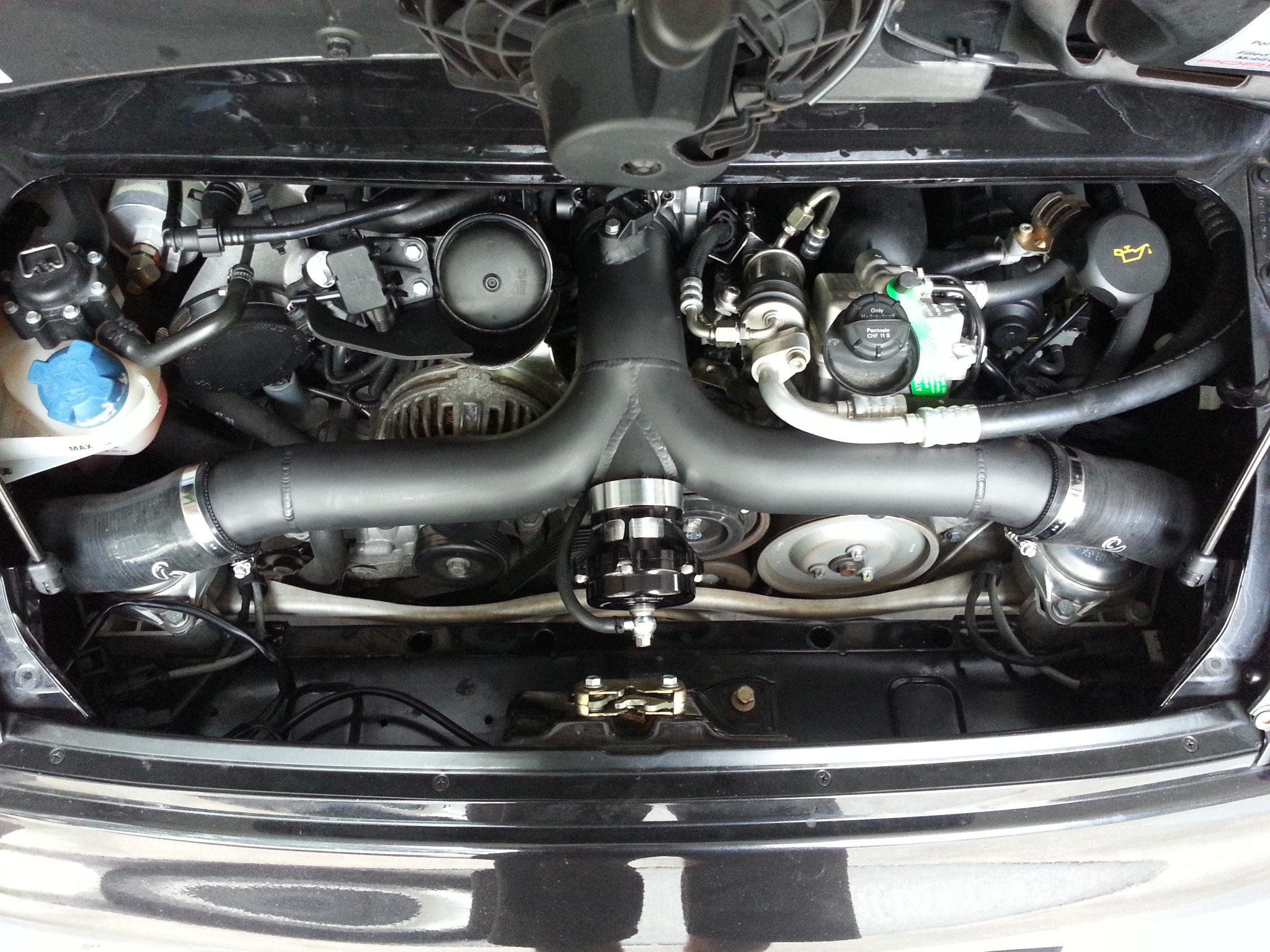

Don't do it unless you can do it right but to answer your question, yes.

so... is the way you did it in that picture the only right way or are you going to explain?

He has the whole dv system removed and is running a blow off valve with filters on the turbos.
