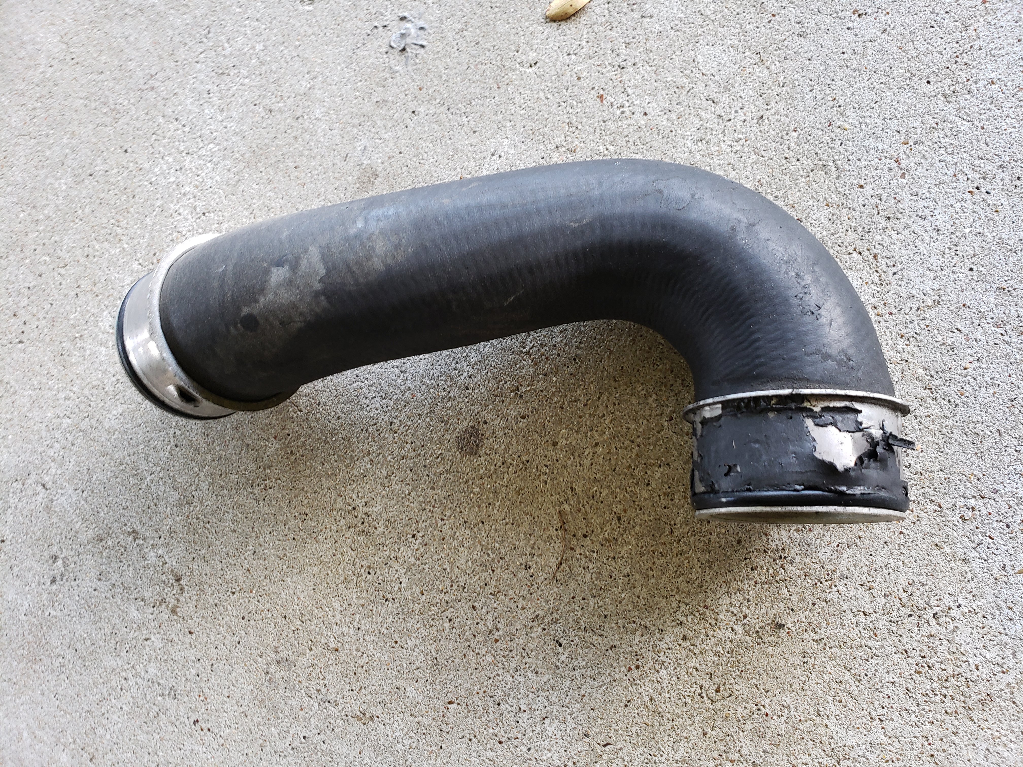

I am in the middle of this myself. I just replaced the water pump only to discover that one of the overly engineered hoses (metal glued to ends with O rings) is leaking, it won't seat any longer. The replacement arrived yesterday and I'll tackle it this weekend.
I too have smelled coolant, but assumed that I found all the leaks. I'll know soon enough.
I will say that any leak for the past year or so has been very minor with very little coolant lost in the system.

Glad you figured it out and it was a relatively simple fix. Mine was simple too, but frustrating as well.
The retainer spring was the wrong size and the hose just pulled right out. Some genius decided that silicone was the solution instead of figuring out why the hose pulled out. Took me 2 minutes to see the problem.
I don't believe this was leaking much, if any, prior to the new water pump. New hose installed, waiting for the $4 spring with $9.50 shipping.

That's great, gadangit, still not fun wrangling those short pipes out and getting them back in but glad it was an easy find. It kills me that those clips are different sizes on each end of the pipe. Thankfully one of the guys on here let me know before I made an error putting it back together. Good luck with the fix.
