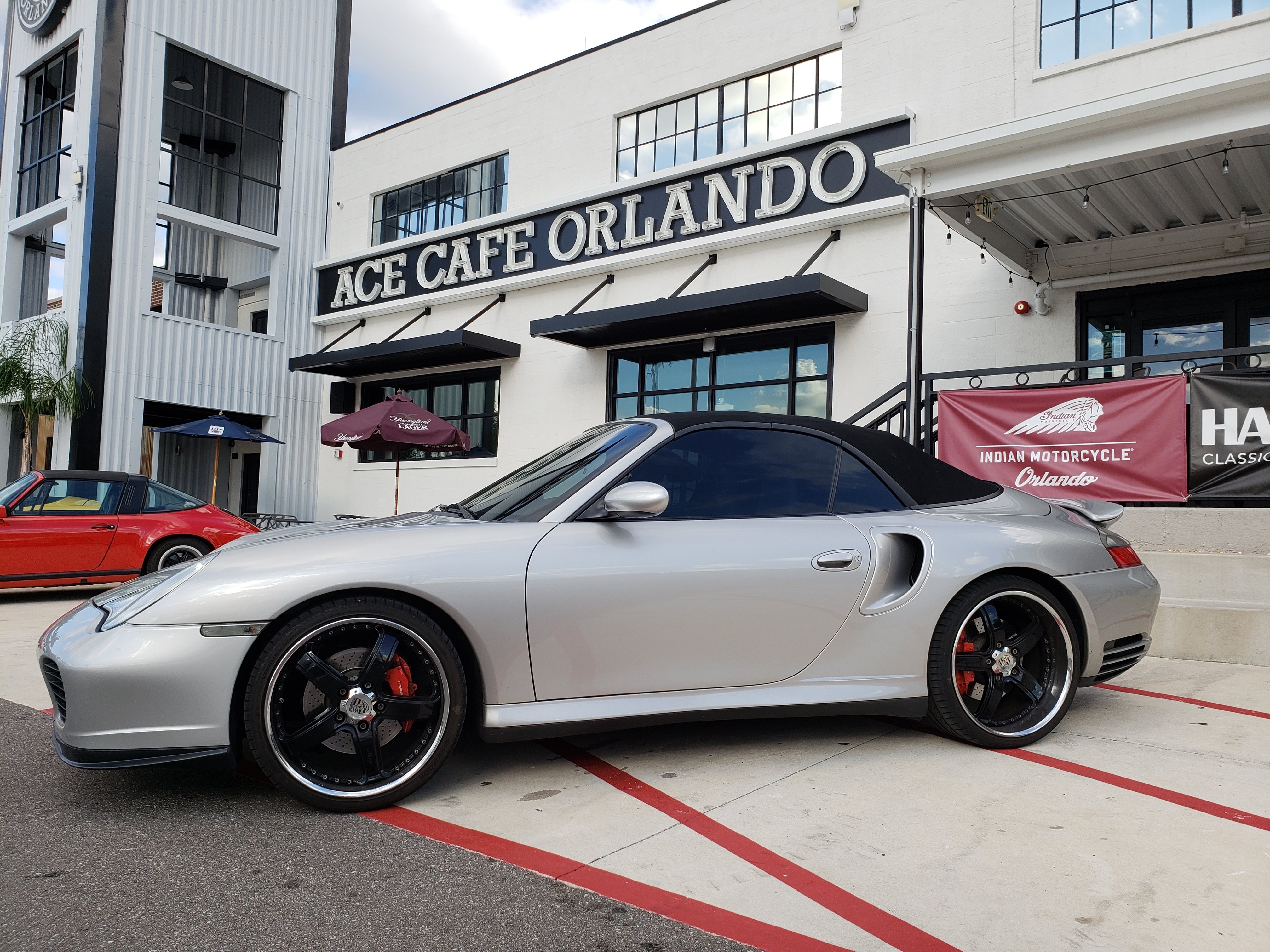

Here's the fitment I'm running:
20x8.5 et +45 245/30/20
20x11 et +47 305/25/20
I could even add a spacer to my rears, if I wanted. Theres plenty of room if I wanted to move them out some. The fronts sit perfect.
The number one thing I would do is verify the offsets, which will be stamped into the wheel somewhere. Get pics of the offset (or whatever level of confirmation you're comfortable with) and we can help you from there.
I forgot to mention that I've had these on for 4 years and previous owner had them on for who-knows-how-long before that!
