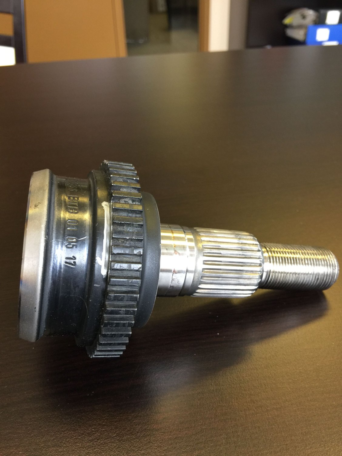

The pictures show how much of the spindle gets removed. Total weight of the spindles is 5-1/2 lbs before machining. It cost me $110 to save 1.25 lbs.
I’ve had the for 10 years, it is very unlikely i will ever sell it. There is no way I’m ever going back to AWD after a few years of RWD. It’s a no brainer if this is your position.
