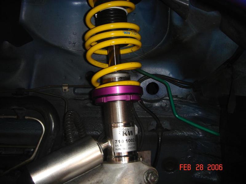

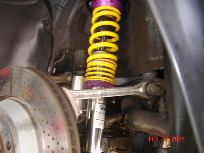

I bought mine on sale from Danny @ KMD tuning for about $3100.
Oh yeah, one more comment. If you notice the ride height in the picture, the guy who installed them told me this was the maximum installation height as suggested by KW. In other words, if I were any higher they would be slightly out of the manufacturer's recommended setup. which I assume means that there is very little chance of having bump stop problems with the rears.
The fronts are in the middle of the range...
wheels are 19 in.
Matt
