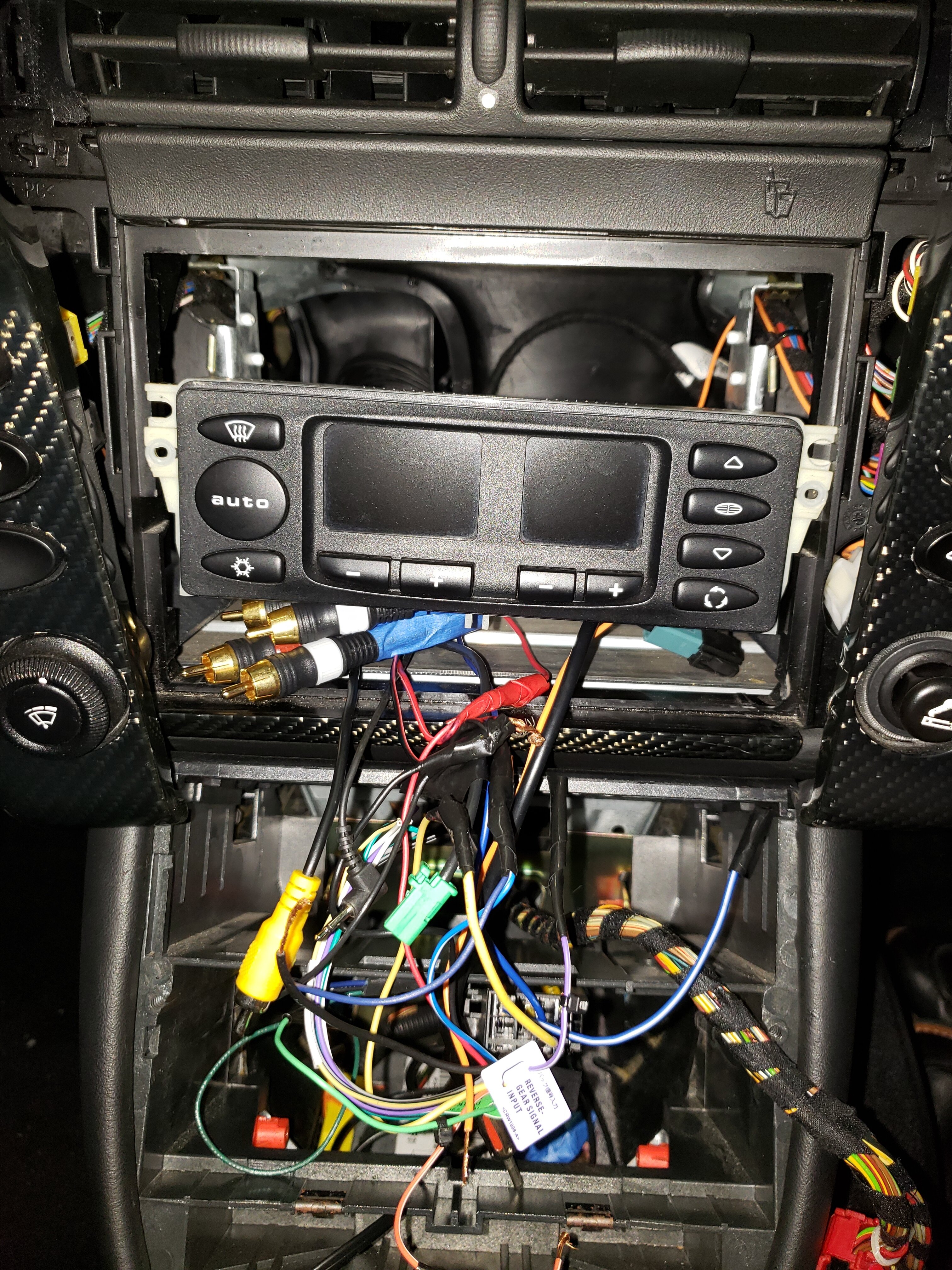

The car came with nav and bose. I installed an aftermarket 2din and it died. I dont like any of the current 2din units and decided to go more simple. I bought the Continental single din. So now I'm trying to go from that double din in the upper section to a HVAC controls + single din radio, i.e. to the more basic setup. I thought you could just swap the units around but something is missing.
I want the two storage bins in the lower console and they just pop in and out - so that's not an issue at all. I already have them on hand.
I am clearly missing some kind of mounting bracket inside the dash for the hvac to go up top, but I have been researching the heck out of it and am turning up blank. It seems everybody wants to go the other way and has skimped out on the particulars I am interested in.
I'd love some guidance on this.

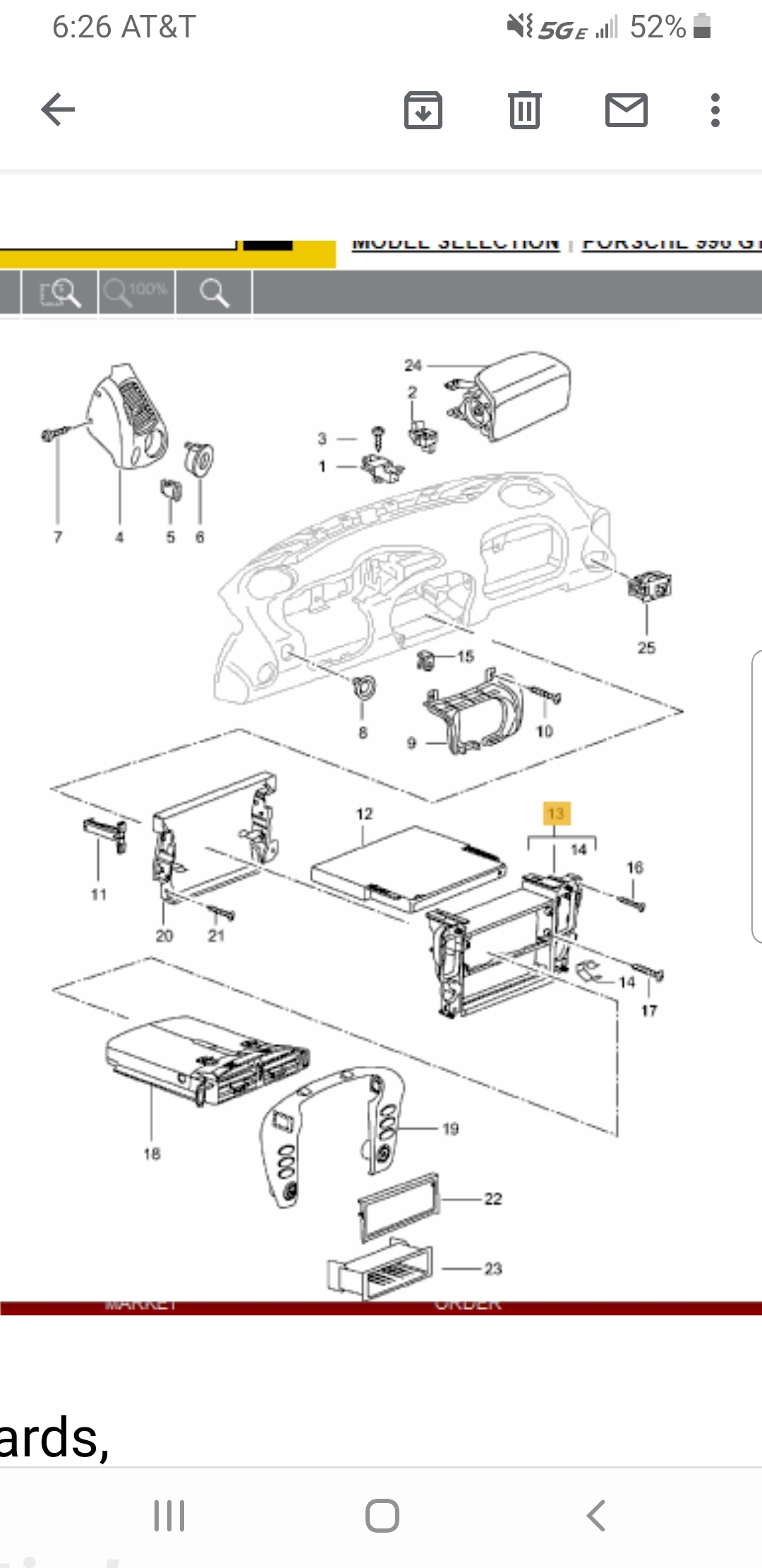

So I figured it out... need to replace the frame under the horseshoe.
#13 in diagram. Also need (2) of the #11, the item I linked above.
#13 is p/n 996-552-231-11-01C-OEM
#11 is p/n. 996-573-501-00-OEM

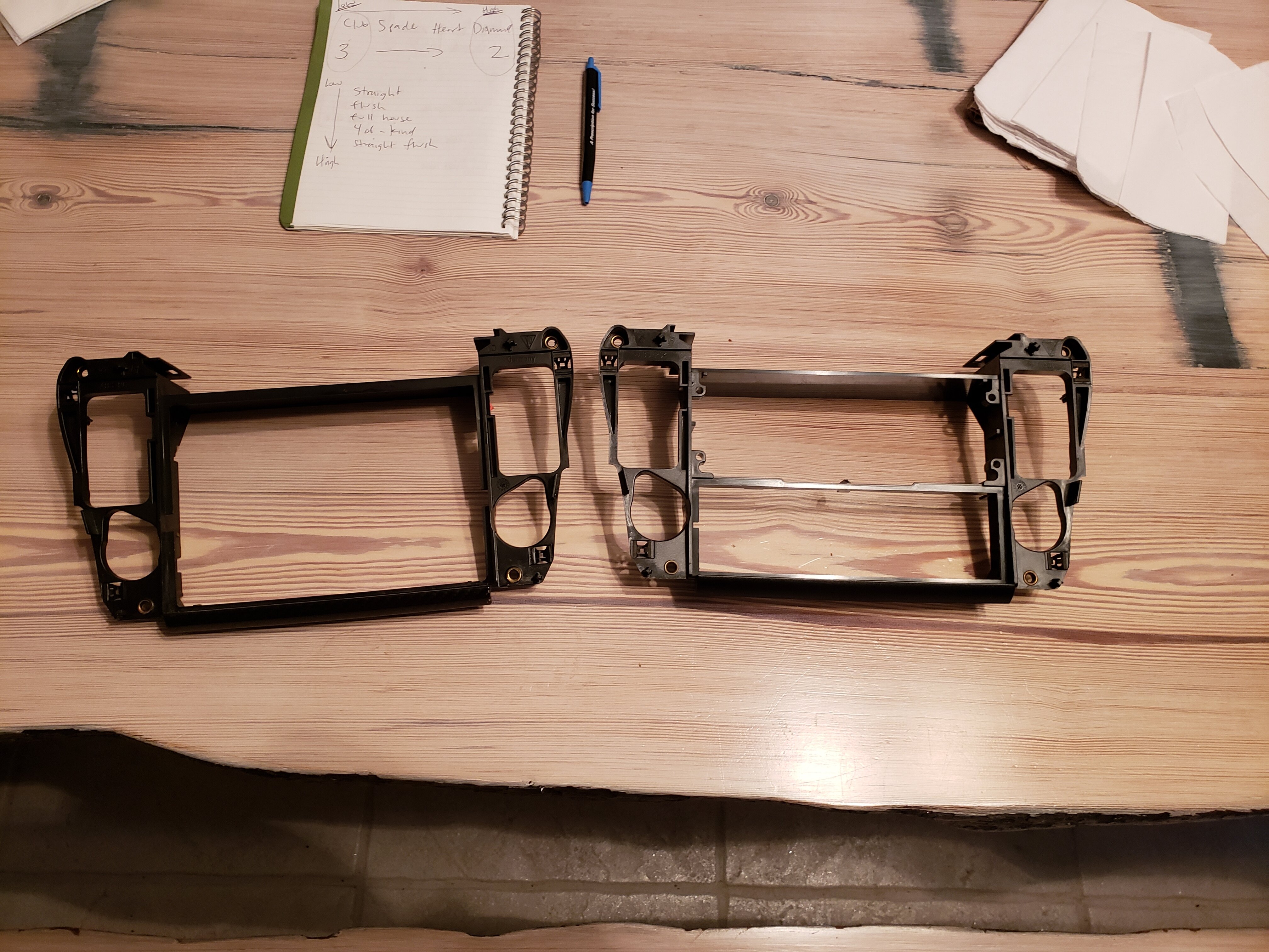

Side by side comparo of the 2004 upper double din frame unit p/n 996.552.231.12
Vs the upper HVAC/single din combo frame p/n 996.552.231.11
Once I receive the additional little supports I'll be all good to finish her up!

Yep, I remember having to dremel that one on the right, then not being happy with how that came out, then ordered the one on the left. Sorry I didn't remember the specifics and part numbers to help you out
