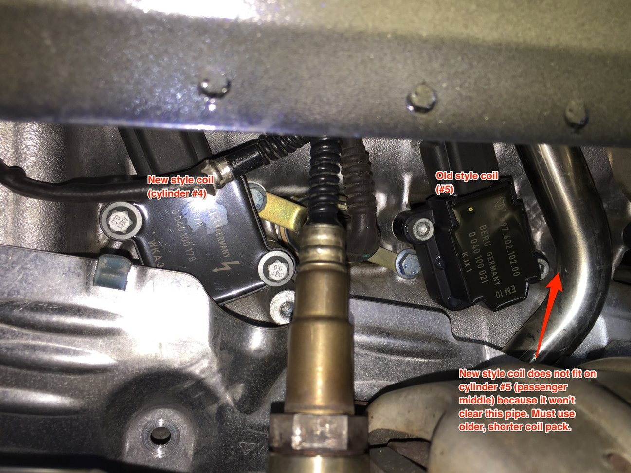

Actually. That part number I listed is old and the new coil packs ARE taller and need longer bolts, but what about cylinder number 5? What will fit under that hard water line? Definitely not the taller coil packs? ECS is not much help at all on this subject. They said they "Don't know". I just ordered the 5 then and longer bolts. Now what can fit on number 5?

I was able to fit the taller new style coils under the tube there on #5 no problem. For bolts i purchased a bag of the standard SST hex head (10mm) cap screws from Mc Master and used them on all the coils with no washers. Shields fit just fine

That's strange? From what I'm reading all over this forum is that the new coil packs won't fit. Think it's the bolt that gets in the way? That makes sense to me as a typical bolt might be able to turn with an open end wrench under the pipe, but can't get a socket on the top I'm guessing???

SWEET!!! The "normal bolt" does look like it would be much easier to torque with a standard wrench and fit into those tight places easier. What is the thread on those? 10mm head, 40mm length, what is the thread size? Thx so much man!!!

M6 × 0.75 mm
40mm Fully Threaded Fine 10mm 4mm 100,000 ISO 4017, DIN 933 10 92800A186 5.63
Does this look correct? 10mm hex head, fine thread, 4mm bolt head height. From Mcmaster

I ordered the 99760210400 coil packs which are supposed to be shorter. I don't see anything about longer bolts with these. Where are you looking? The link you posted has a different part number. I also called ECS and was told they are a direct replacement.
i linked them on the pelican parts page above! get the OEM BERU 997 part# that come with the LONGER bolts and simply install them
i even listed the BOLT PART numbers! lol
you're making this far more difficult than it is

M6 x 1.0 40mm 18-8 stainless from McMaster Carr. Item # 91287A342 $7

I haven't started putting new coil packs in yet. They keep arriving with broken tabs. Have 9 and only 4 have all the tabs. I'm gonna have to find a good way to secure them b4 I start. Heard liquid electrical tape fills in the tabs and holds like weak plastic and good for 250 degrees F. The tape/plastic comes off easily when unclipping them he says, so no build up or something to mess anything up.
