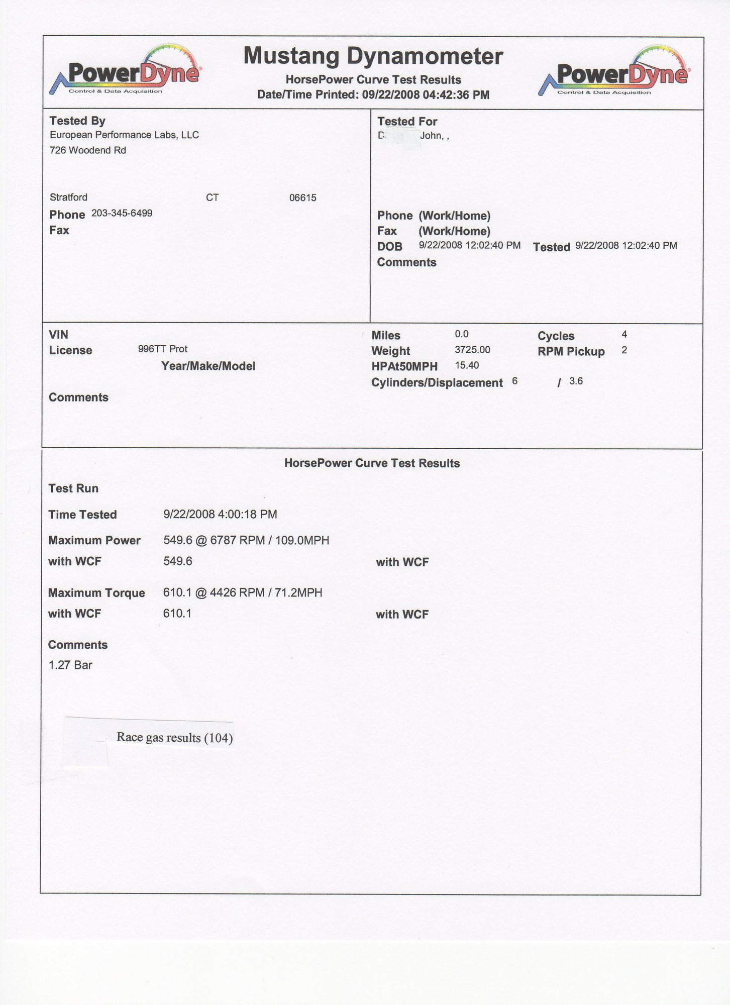

I just found an old dyno - max torque in my case was 610 ft/lb. or 827nm with K24/18G's at 1.27 bar. I have since tweaked the tune to 1.32 bar. IMO, it's borderline at 890nm. I had to go to a twin disc setup to hold the power in cooler weather. The car would overpower a new Sachs motorsport GT2 disc with 764PP. I even tried a tweaked 764PP by Clutchmasters that was supposed to add significant clamping force to an OEM 764. Still didn't hold.

My dyno guy estimated 690 flywheel HP on race fuel and about 650 flywheel HP on 93 octane.
