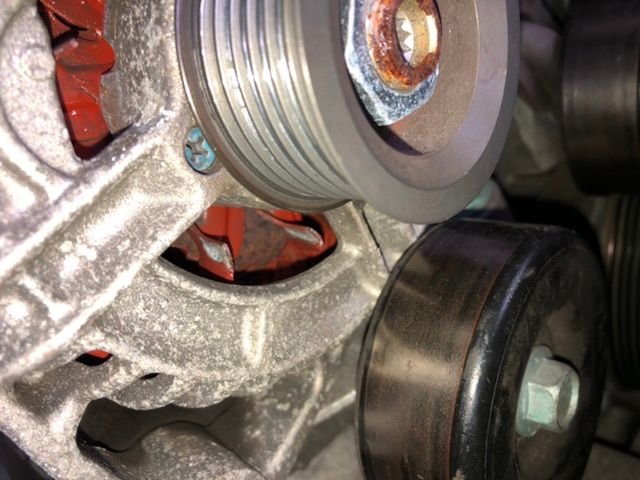

I finally made time to work on the Porsche. Took the serpentine belt off. All of the pulleys feel solid and smooth. So, I started the engine without the belt and the sound is gone. Looking close, I am pretty sure it’s the alternator cooling fins; somehow contacting the alternator body at the 2,000 rpm mark.

sounds and read like metal on metal to me. good for you for sorting it out.
