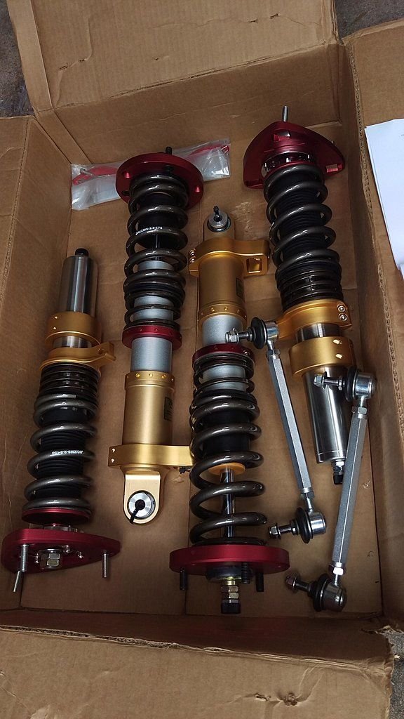

JIC Magic will build u a custom set for juust over 2k money.
I have them & really like them.
