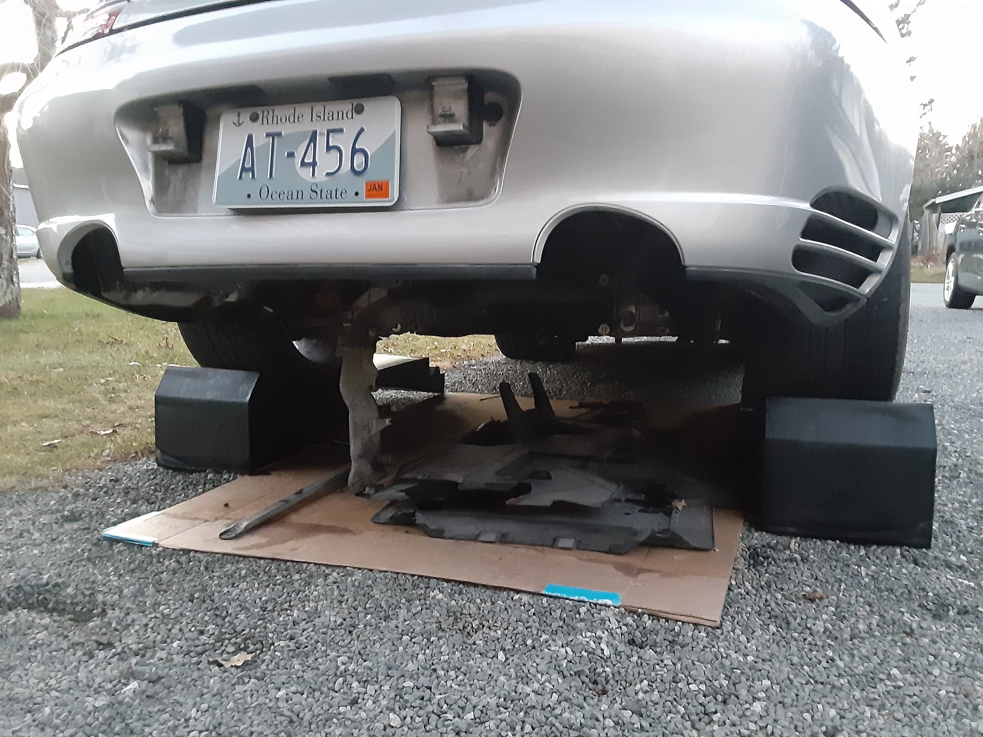

I didn't take many pictures as I wasn't fun on the gravel driveway. I need to make some space in my shed tomorrow.

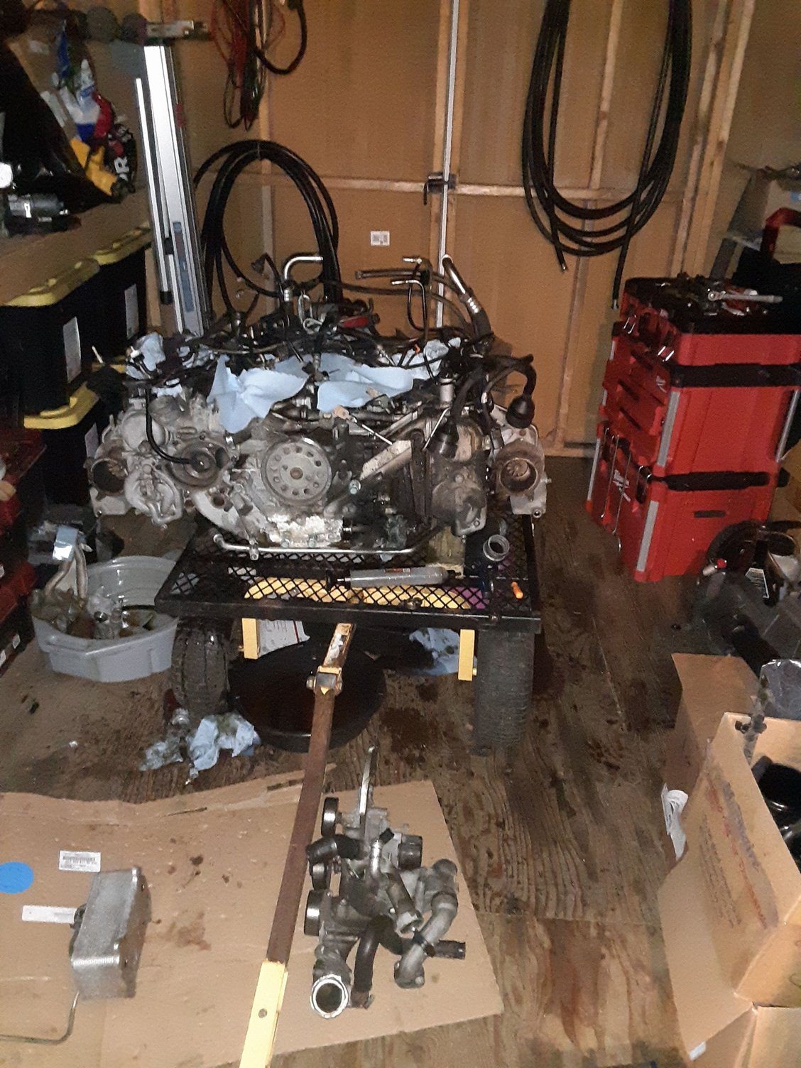

Thanks guys. I am realizing some of the rubber hoses need replacing as well as an intake boot due to a chf leak.
its coming apart nicely
