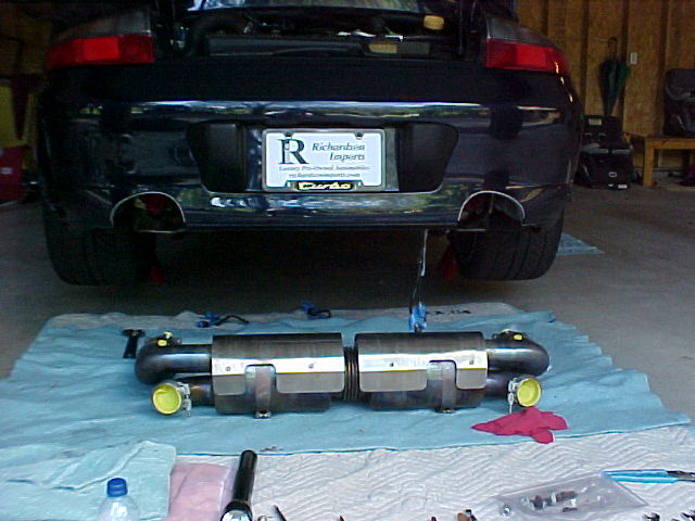

DIY exhuast 996TT:
Name:  PSI ready to go in 996TT.jpg.JPG
Size:  59.8 KBto get the top nuts I used a combination of about 5 different length
13 mm wrenches (open and closed), as well as a 1/4 drive swivel
wrachet, with swivel and a couple different lenght extensions. By the
time I was done I was laying on a "sea of tools". overall not difficult,
but it will take 3-4 hours if you are laying on your back (as opposed
to having a hoist). I have done it 3 times also--final result:
PSI Quiet == Perfect !!
