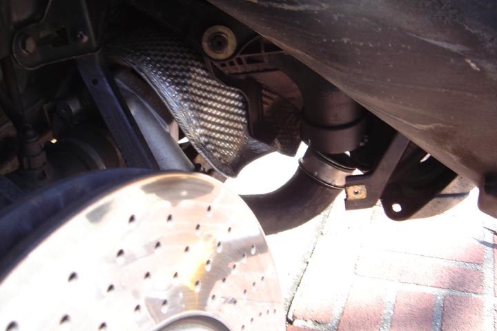

It may not be your MAF, all three of my lights went off today, turns out it is because of a weak link in one of the hoses, yours maybe lose and not all the way off, mine completely blew out and after reconnecting the PSM and ABS light went off.

I'm no expert but to check where my problem was you have to remove the rear wheels and pull back the plastic wheel well liner (You could also lift your car and check for under). I do remember other members having boast leak problems and had a test done on the entire system, I don't remember how they did this test (wish I did), I think Orli's test was very helpful and fixed his problems.
