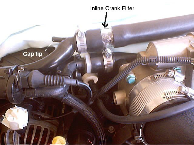

One suggestion
Originally Posted by HotRodGuy
Was just curious if any of you guys run a catch can on the p-car motors
This is a DIY in-line crank case course filter type routed back to intake on my SC system for my 996. I choose the course filter gl*** see through type instead of a catch can because it fit nicley and can be easily monitored and cleaned periodically, this goes along way in keeping my IC cleaner longer. If you wish to see DIY or maybe will give some ideas of your own go here.
http://www.webbspot.com/porsche/html/crank_vent.html
