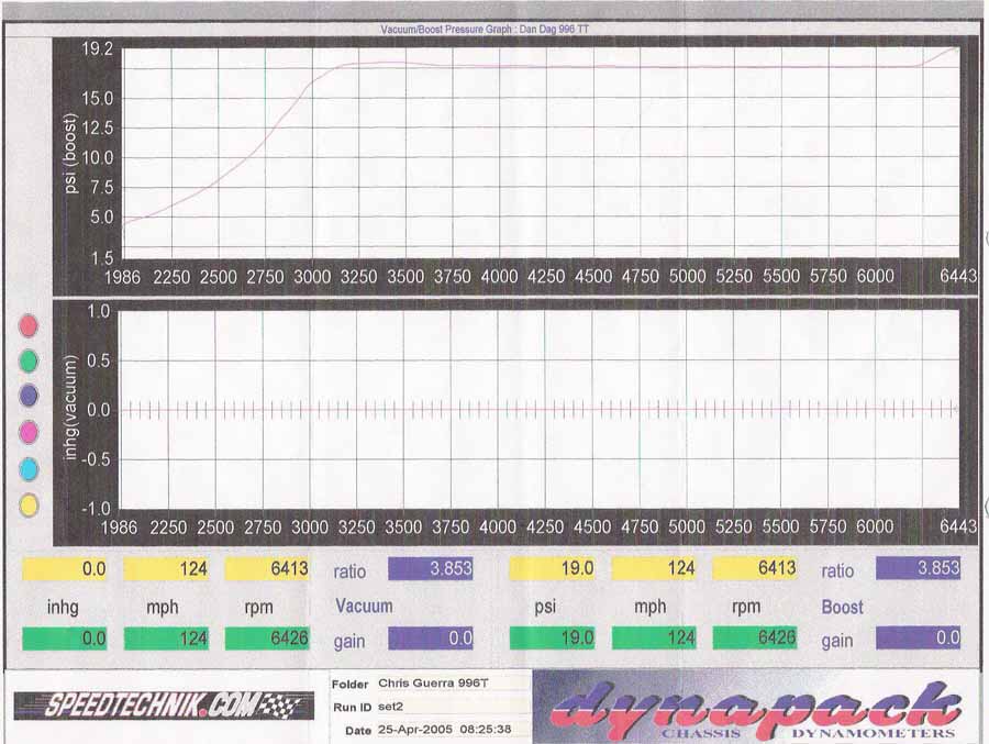

Dyno graphs, stage 2. Help me analyze them
I have the dyno from when my car was just tuned by EVOMS. At the same time, a stage 1 clutch was installed, evo intake, fabspeed exhaust, and ROW suspension. What do you guys think? I'm seeing 448 rwp and 477 rwt. The front drive train was disconnected for the dyno. The tuner said the car should show more power after a while (it was dynoed immediately after the mods). I regularly see 1.2 bar and occasionally 1.3 bar on my boost gauge . The car seems really fast.

AFR and boost graphs...

So no before dyno? SAE HP 441 Tq 473...Stock is 415HP...so do the math for your stage 2. That seems disappointing.
Those are whp figures so it calculates to 504 bhp I believe.

It says fly wheel power on the title of the chart. Oh just saw your note (don't think it was there when I posted?). So I get 496HP (multiply by 1.125). Excellent. Have fun.

Seems like A LOT of boost for K16's and not that much power for all that boost... Somthing strange IMO... As a comparison, I dynoed 468RWHP at .9BAR MAX...

Yea exactly! One thing i noticed about my car is, with straight pipes it would boost the 1.1 then steady 1 bar flat, i took them off, with my exhaust i can get 1.0 but steady .9, and .9 just pulls HARD. It just seems much more accuarate and better for the car to pull a .9-1.0 with useable great power. 1.2-1.3 is overworking those turbo's and blowing hot air.

If you look at the top of the curves it shows 477 ft/lbs and 448 hp. So x 1.125 is 504 bhp and 537 ft/lbs. Does that sound right?

Either your stock Boost/Bar guage is mis-reading or something is wrong. Its impossible for a Stage 2 with "Stock" K16 Turbos to pull 1.2 Bar and even 1.3 at times. Stocl K16's that have not bee modified can not push that much boost.
As fas as your HP, it seems about right give or take a few HP. Figure 500 HP for a Stage II and 550HP or so for a Stage III and so on....

I was wondering if it was reading hi but looking at the boost graph, it shows 19.0 psi which I think translates to 1.3 bar. Isnt 14.5 psi = 1.0 bar?
I think 1 bar = 15.7 psi

It really depends on the car. My car trapped 126 mph at the Stage 2 level (with stock K16's, AWD and full weight car)...which means I was very close to 600 hp at the flywheel.

14.7 psi. One bar is almost exactly 1 atm.

1 Bar = 14.7 Psi
19 Psi = ~1.3 Bar
Stock K16s can not mainatin 1.3 all the way to redline from what I have seen.
Here is my stage 3 K24 Graph in RWD: http://members.dslextreme.com/users/...11%20Turbo.jpg
