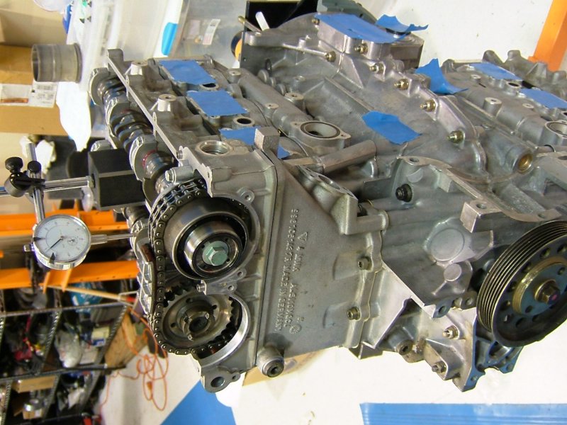

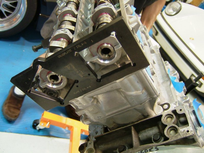

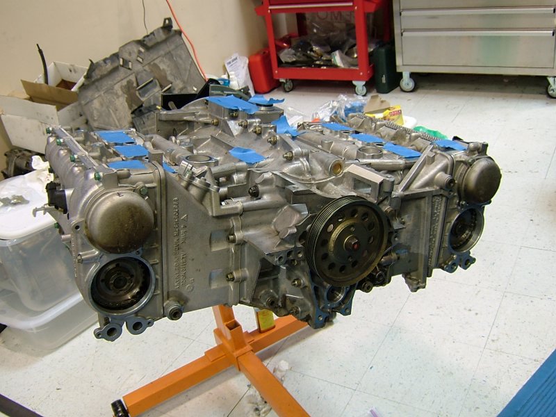

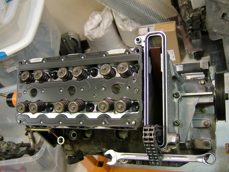

Some more close ups. Some setting, timing, adjusting (cams for example) and using big **** wrenches. Tag teaming and more Porsche tools. I knew we needed them for something. And the long block is back together once again.

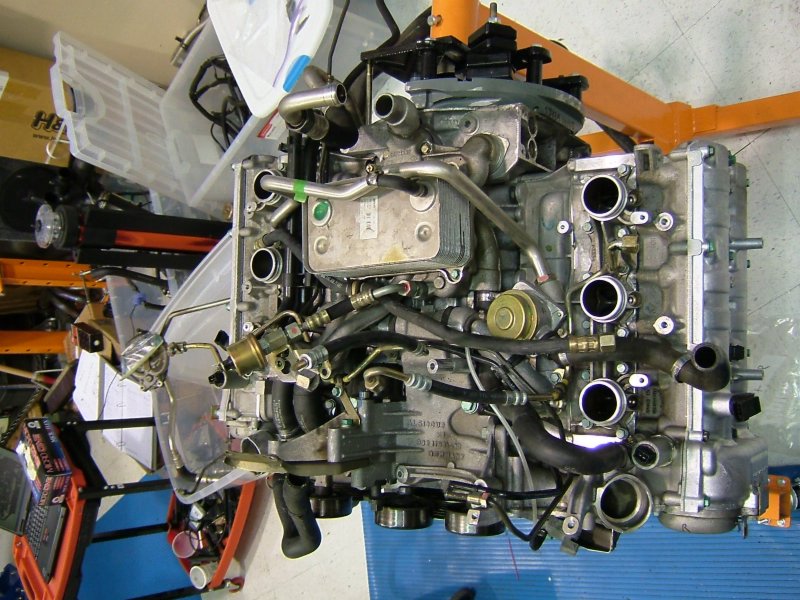

And then we go to the parts bins (all 9 of them) and dig out bits, pieces, hoses, bolts, hoses, bolts, more hoses and start putting it back together.

I'll post the rest later on but suffice it to say this car is now fully-built top-to-bottom for the GT700 kit (I won't "bore" ya with pix of that- posted 'em too many times already lol) and new Stage III Clutch kit (yes with a LWF) and Motons. Obviously with break-in there's not a lot of "fun" to be had on this car just yet. Either way the bay area has another 10 second 996TT
