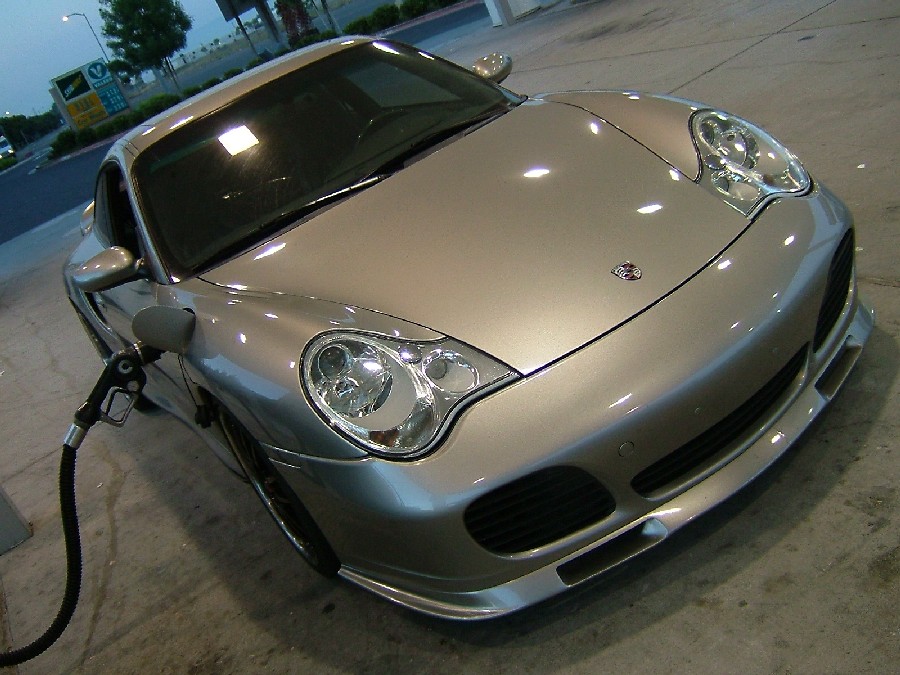

Old Jul 22, 2006 | 05:09 PM
  #53
sharkster's Avatar
Posts: 23,879
Rep Power: 1517
here she was... a GT700+ on her maiden voyage going all of 15-50mph between 2000rpms and 3800rpms to the gas station
Again, I've never seen this color before on any 996TT (I'm told it's the only one?) but it reminds me a lot of the Batman Lambo. Stunning.
Old Jul 22, 2006 | 05:26 PM
  #54
Craig's Avatar
Posts: 2,803
From: Missing in action
Rep Power: 214
Craig Is a GOD !Craig Is a GOD !Craig Is a GOD !Craig Is a GOD !Craig Is a GOD !Craig Is a GOD !Craig Is a GOD !Craig Is a GOD !Craig Is a GOD !Craig Is a GOD !Craig Is a GOD !
Is that pump gas you are putting in the tank . . . shame on you.
Craig
