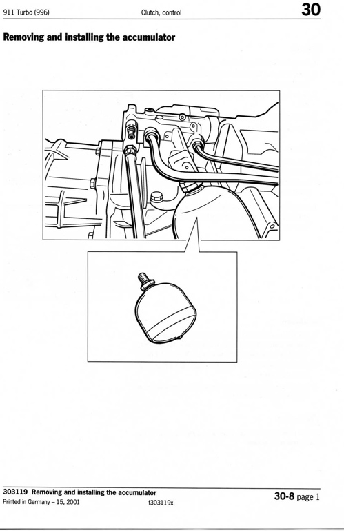

Okay... I just checked the service manual and replacing the accumulator is an absolute piece of cake. Get under the car, remove a couple of screws, remove the accumulator, put the new one in. I scanned the procedure if anyone is interested I'll upload the instructions.
Joe
Joe
an upload of the instructions would greatly be appreciated.
Thanks in Advance.
Sameer
Thanks in Advance.
Sameer
