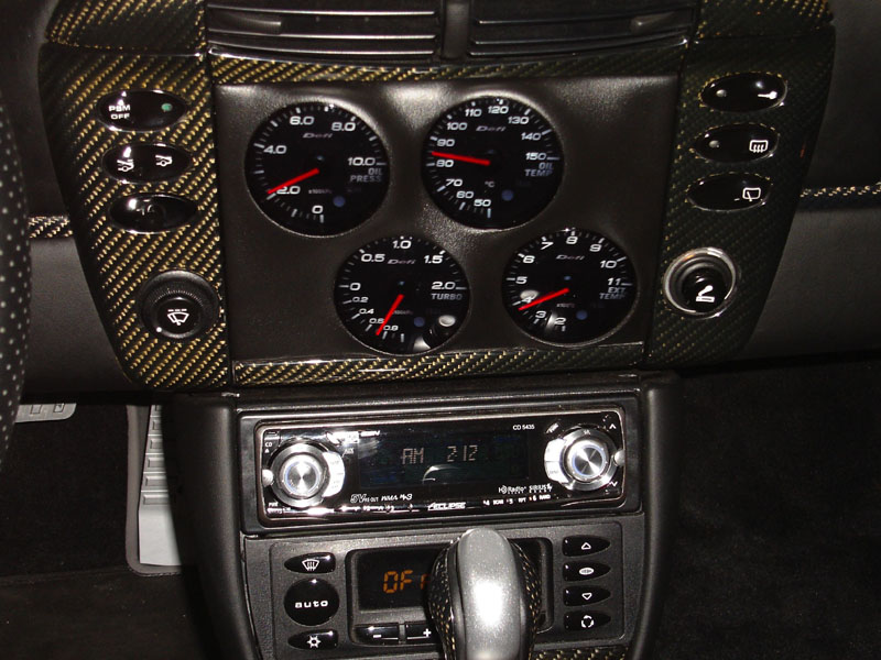

Here is what we built for Shank. On the EBC we use the EVC5 from HKS.

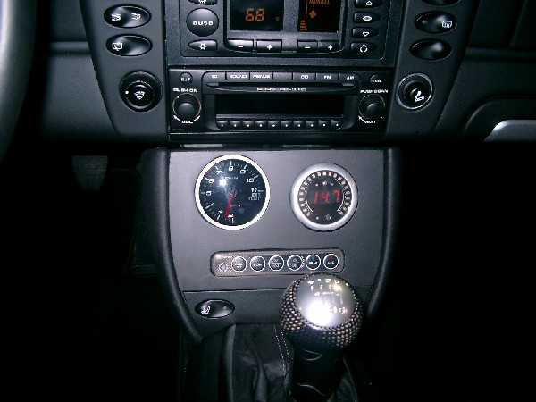

This is what i built for a fellow member.Name:  stereo1.jpg

very cool setup!

Markski... I like it. Very clean!

Spend the extra time and counter set those gauges! It makes a huge difference from something that sticks out to something that looks as if it should be there. Mine were flush with the panel.
