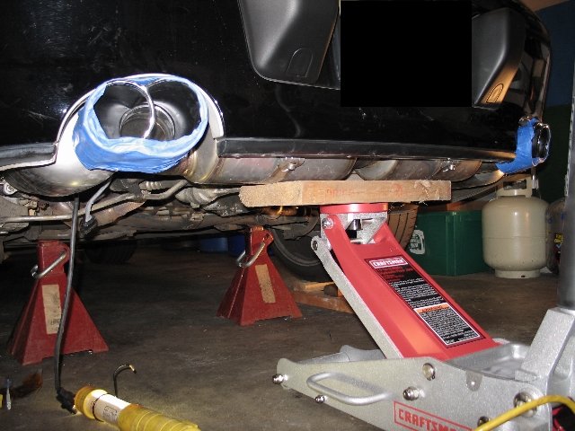

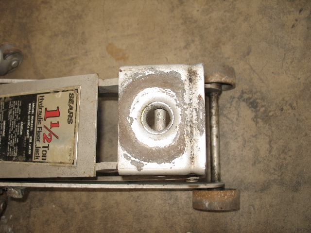

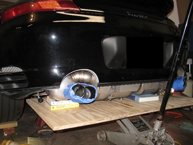

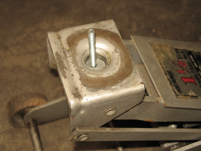

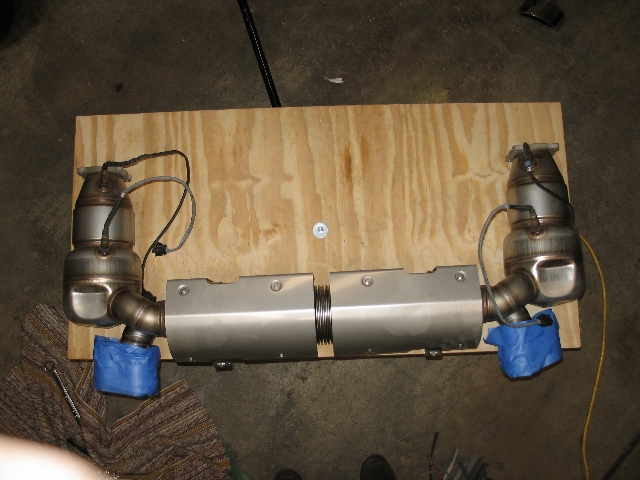

I used a 24 inch by 48 inch pice of 3/4 inch plywood. Thanks go to Kevin@Ultimatemotorwerks for this idea and other assistance. I then removed the saddle cup from a Sears floor jack. See pic 1EP. I then located a 5/16" carriage bolt of the the proper length along with some washers and nut. See pic 2EP. Drill a 5/16 hole in the middle of the board and attach it to jack. See pics 3EP and 4EP. Pic 4 shows the Europipe ready for installation with the tips and O2 sensors attached. Pic 5EP shows the tools that Europipe provided. Those small head 13mm box wrenches with the extension tube make getting access to the mounting studs on the turbo easy.

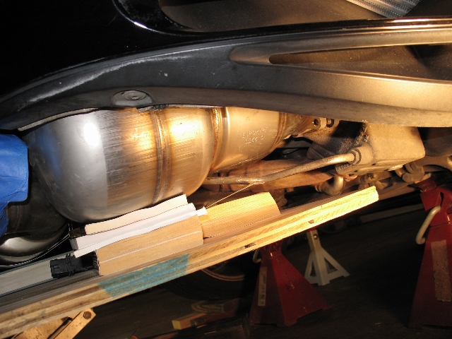

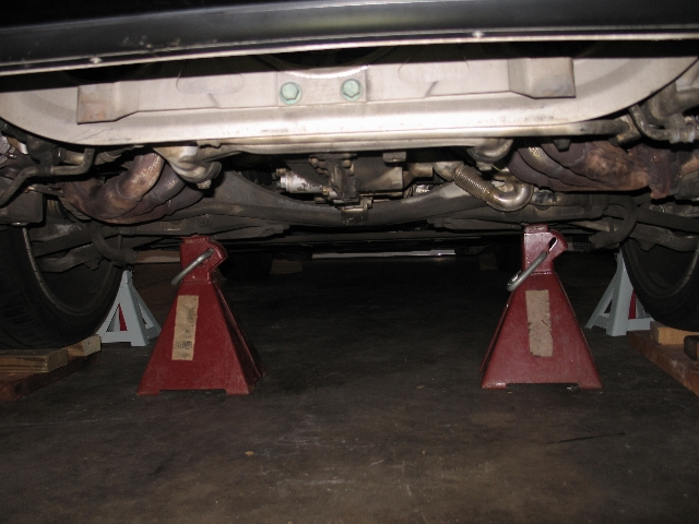

I jacked the car with a floor jack under the motor as recommended in the Imagine Auto writeup, but I put the board under the motor with the grain of the wood parallel to the rear axle, so as to minimize splitting the board with the wedge effect of the motor. Pic 6 shows six points of lift support, the four jack stands and wood blocks under both rear tires. The front tires were blocked and the car was in gear with the E-brake on. There is a lot of weight over your head, and I wanted a failsafe approach.
Pic 7 shows the installation platform in position. Pic 8 shows a good use of old paperback books. They are used as shims to get the cats safely above the turbo oil lines. I positioned the mounting holes on the cats on the lower turbo studs. See also pic 8. Then you use the jack (pic9) to slowly raise the muffler while looking carefully that the system is not hanging up or damaging anything. Watch your O2 sensor wires and make sure the system does not drop off the lower turbo studs and is not resting on the oil lines. I had to pull the rear fascia out under the license plate with my hands just a bit when I jacked up the platform so that the muffler cleared it. Then I just pushed the system up onto the upper turbo studs. I put one nut on each turbo to hold the system in place on the turbos. I then removed the platform jack while holding up the muffler with the other hand and positioned the other floor jack with a smaller board under the muffler. See pic 10. This enabled me to get access to the muffler clamps. Then just torque all the nuts and adjust the tips.
