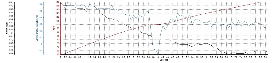

I tried graphing it using the P-box software, but the lines are so close together it's illegible. Maybe someone with some real Excel skills can graph it out using the below info.
Anyway, here's how the race would have went down assuming all three cars started nose to nose at 60 mph:
70 mph:
Scott is in the lead, with Peter 4 feet back and Tym 1.5 cars back.
80 mph:
Scott is still in the lead with Peter 3 feet back and Tym 2 and 1/4 cars back.
90 mph:
Scott shifted at 83 mph and Peter takes the lead.
Scott drops 2 car lengths behind Peter and Tym is 8 feet behind Scott.
100 mph:
Peter shifted at 91 mph and Scott takes the lead again. Tym passes Peter.
Peter is 1.5 cars behind Scott and 3/4 cars behind Tym.
110 mph:
Scott is still in the lead, with Peter 2 cars behind Scott. Tym shifted at 106 mph and drops back 4 car lengths behind Scott and 2 car lengths behind Peter.
120 mph:
Scott shifted at 116 mph and Peter takes the lead.
Scott drops 2 car lengths behind Peter and just 1 car length ahead of Tym.
130 mph:
Peter reaches 130 mph first, with Scott just under 2 car lengths behind and Tym 1 car length behind Scott.
Here are the actual mph and distances for each:
Peter
70 - 46.50
80 - 94.06
90 - 159.16
100- 285.80 *Shift at 91 mph
110-385.67
120-504.09
130-653.71
Scott
70 - 42.41
80 - 90.93
90 - 185.77 *Shift at 83 mph
100-264.89
110-358.89
120-532.51 *Shift at 116 mph
130-681.58
Tym
70 - 63.74
80 - 123.51
90 - 191.96
100-273.47
110-418.30 *Shift at 106 mph
120-546.05
130-695.90
I'm not sure... but I think I just got motion sickness. Someone let me off this ride, LOL!

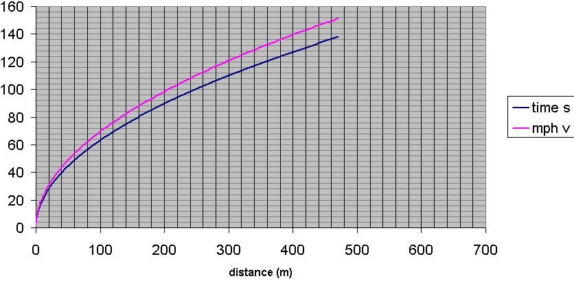

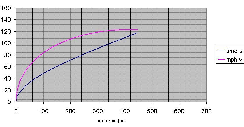

In the first post of this thread there is a very long explanation why ET and trap speed of a quarter mile run can differ with different runs and cars.
I would like to try to show you a shorter explained version which put some light from another side:
Why does ET and trap speed of a quarter mile run (or any other distance) differ?
Simple answer is: because the process/the distribution of acceleration (increase of speed per time) is changing over time and distance.
this is very similar to a turbo and a n/a engine which have the same (max) power, but completely different distribution of power over the revs (->torque).
If you consider cars that have a constant(!) acceleration, it would always have corresponding ET and Trap speed.
This is not true if you only take an average of your acceleration.
Here are two examples in terms of raw numbers, which are perfect to explain, because lower ET has also lower speed which seems strange at the first glance:
Car1 11,0@123 and
Car2 12,8@140.
Both cars have an average of 0,5g acceleration but VERY different times and speed. As you might know from experience, the 11,0 is a car that speeds up fast but has not enough power at the end, and the 12,8 has more power at the top end and probably a bad start.
This two examples were made within excel to demonstrate the influence of changing acceleration. It can be easily done with performance box software also, but here we eliminate errors at the start and during shifting.
Car1 starts well with 1g and is losing 0,09g every 0.1 sec and has no acceleration left at 404meter (=quarter mile).
Car2 is doing 0,5g all the time (has enough power to keep 0,5g at the end)
In easy words you can say: it’s more important to accelerate perfect at the beginning rather than at the end to reach good E/T. this is simply because “you do not need any further increase in speed to make you way, if you are already fast”. Look at the top fueler’s ET that blow their engine after some 60 feet
I did not mention any shift point and pauses, but they are more important in the first half of the quarter mile.
It’s not a secret that great times result from very good grip (drag tires, AWD) and maybe skipping the first gear and use a lot of clutch.
And therefore it is very important to have a light car. There are light VW beetles with 700kg and only 230 rwhp that do times in mid to low 10’s, but they would have very poor standing mile times…
see attached both runs in a diagramm over distance!
